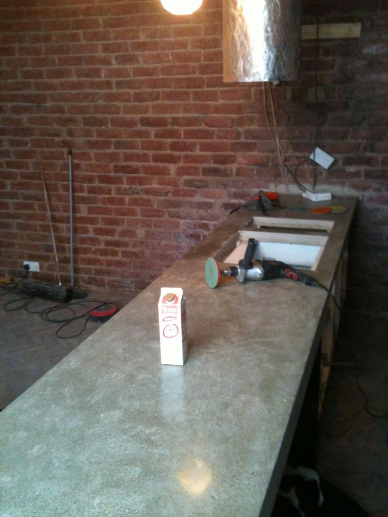

I assume the base board stays there.
The edges extend down past the base board correct?
How did you cast the upstand, just a stiff mix?
What was your mix?
Yeh the 18mm PLY base boards just become part of the counter.
Yes the edges extend 40mm past the base board. So will be aprox 20mm past the finnished door/drawer fronts.
If you look at my first pic of the mold I simply screwed a melamine wall onto the side in 2 pieces. Filled bottom piece first making sure to vibrate mold with side of a big orbital sander & tamping the concrete down with a stick. Then put up the 2nd part of wall & repeated process. Make sure to re-enforce the wall very well before vibrating!!!
There's loads of recipes available on the US websites if you Google them, some recommend using fibers etc but I just used a Portland based cement, sharp sand, plastersicer, and 10mm Pea gravel. 10mm gravel caused me some problems but it was the smallest I could get my hands on at the time. I cant remember my ratios off hand but I get them if you want.
