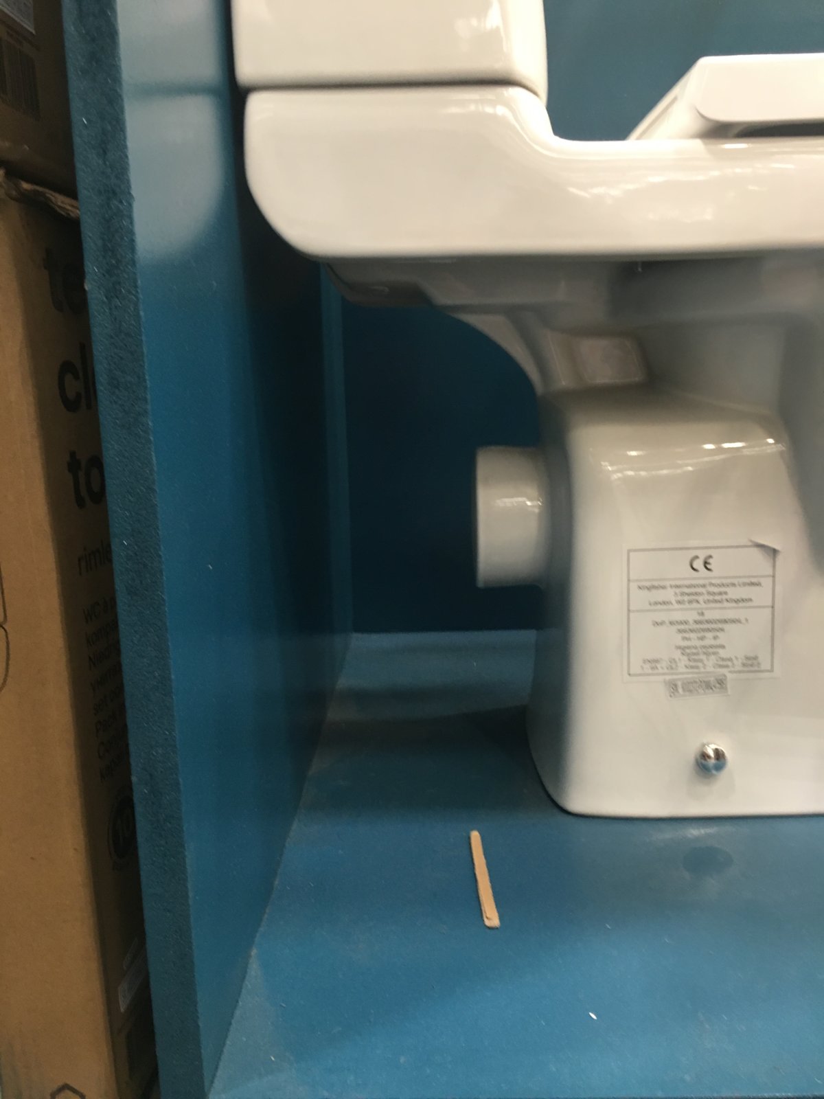

Got my eye on this from B&Q but it’s cistern won’t sit against wall to tune of about 20mm

+30mm wooden baton behind the cistern, tile it or something to make a shelf from.
Yes I was thinking that might be a decent plan but also maybe avoidable. I did actually see tiling it as a good idea too. Suggestion appreciated though.

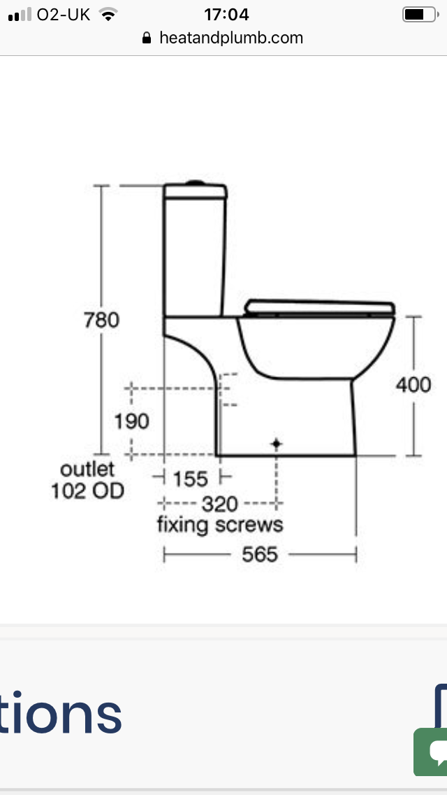

The ideal standard Tempo (pic) was good but there ended up a very short extension required which would’ve firstly needed fixed on the pan side. This might’ve been ok if the rubber boot on the macerator was designed to go on second. It was looking awkward unfortunately

I believe McAlpine do a pan connecter that is secured to the pan with a metal jubilee clip and it can be cut to length then the Saniflo rubber boot is secured to it also with a jubilee clip so it would be totally leakproof and secure.
Thanks I’ll take a look. Tbh though the problem was needing an extension but it needing to be so short the saniflo rubber connection was almost too long. Tricky to describe but as I said, awkward!
On pans such as yours I have had to cut it back to just over the width of the jubilee clip.
Good to know. Thanks for your help on it. I’ll give keeping the Tempo pan another bit consideration before changing it. It is one with good clearance under cistern

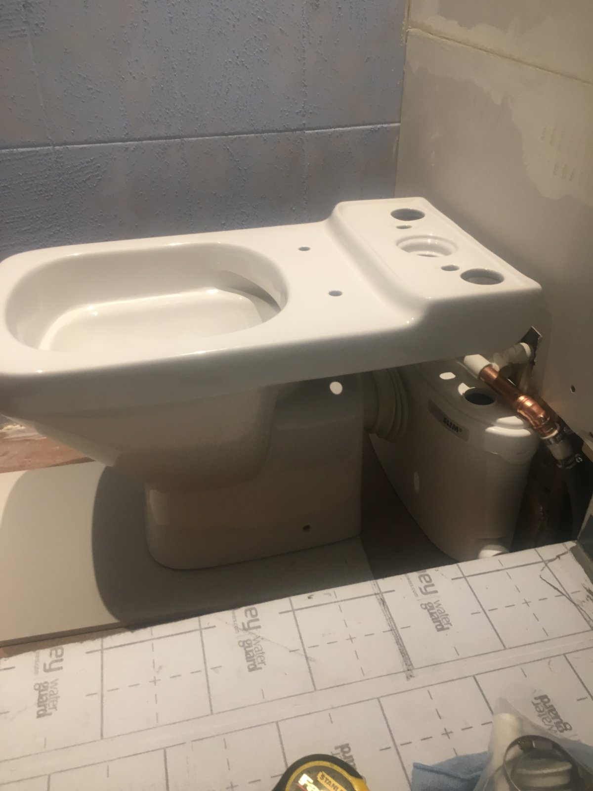

Just to update incase of interest to anyone else. I did do a LOT of looking at what might suit well to use with a macerator and this new B&Q “teesta” is a good one
I’d have probably preferred a known make but it’s a rimless with soft close seat at £125 so not much to complain about. It is ideal with an accessible spigot, good clearance under cistern and nice modern look. I decided to ditch the sanipro I had for a new sanislim but either way this toilet is decent for macerator use.
