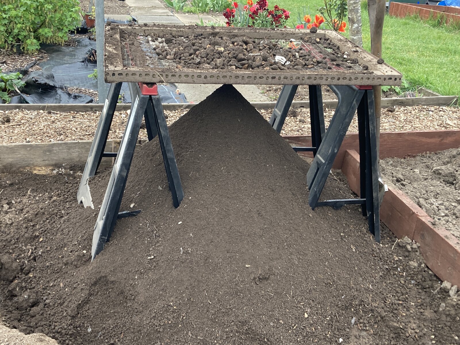

For sieving soil, I borrow my allotment neighbours home-made one. A wooden frame strengthened with some angle beading using a mesh the size required and strengthened with some 3” wire mesh underneath (the sort you use for reenforcing cement). Use it on trestles or straight on top of a wheelbarrow. Shovel the earth on, push it around with your hands using thick rubber glove’s, tip the big stuff that’s filtered out onto your waste pile (or paths if you’re on the allotment). Very quick and easy to use.

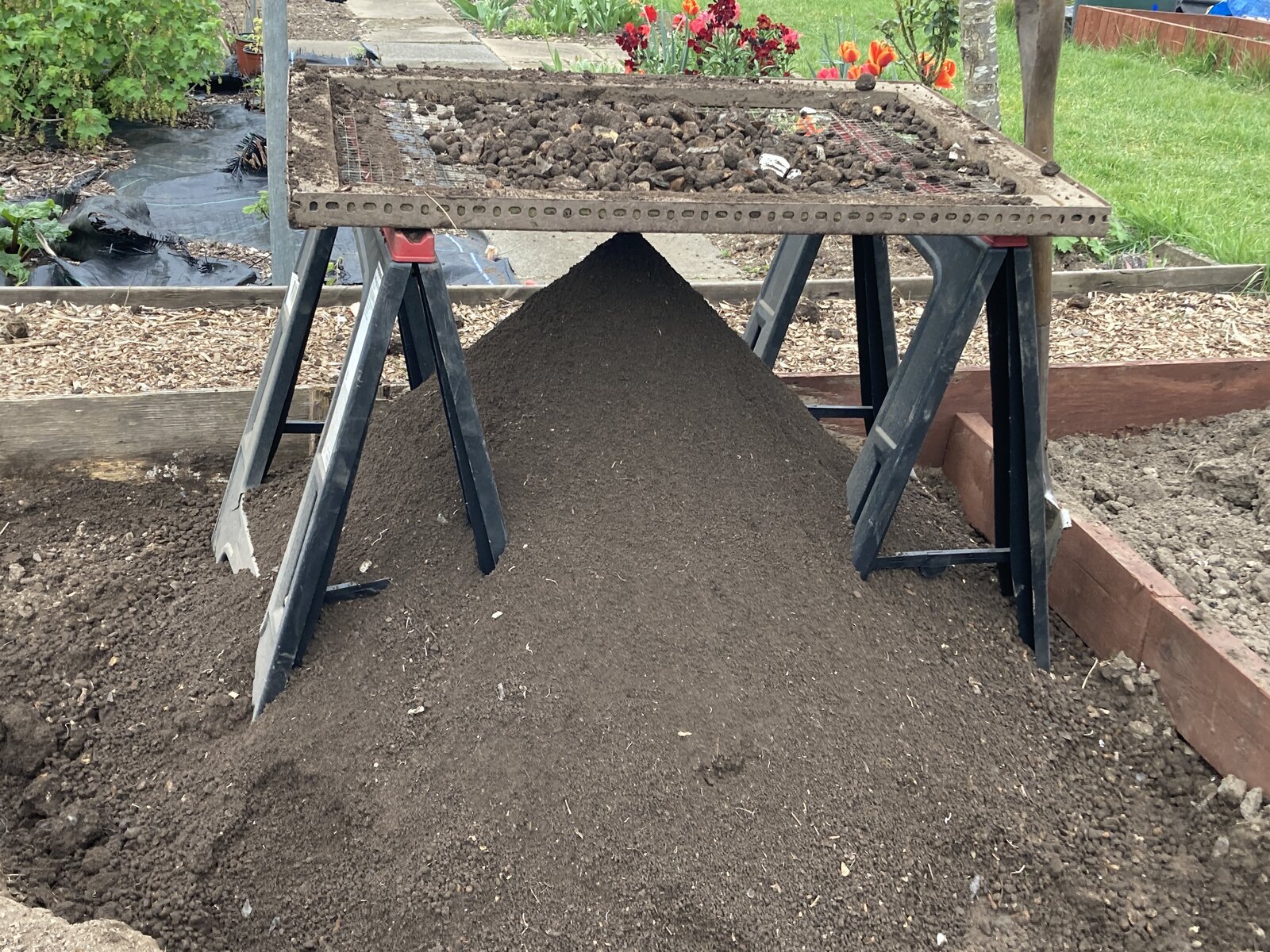

I tried a similar lashup- works ok when the soil is dry, less well when it's damp. What sort of gauge is your sieving mesh - think mine might be a bit tight (10mm round holes)
This just reminded me that a neighbour has a similar thing that he built.. It's a frame like that, but with a Honda GX120 on one end, with an eccentric flywheel on it. The running engine shakes the mesh and he loads it up using a mini digger
