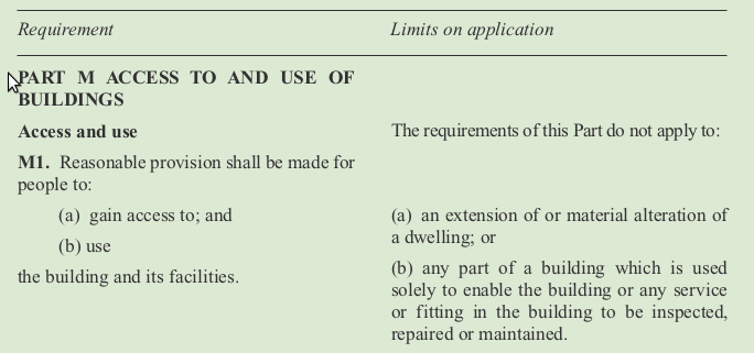

I've read lots of threads about part M only applying to new build and not for rewire of an existing house but I wanted to check if this was still correct in my case.
I have had an extension built to a 30s house and this required me to need to have my electricity supply moved - it previously came through from my neighbour's loft and was moved underground to enter my porch. So I guess I have a new supply ?
I'm now getting the house rewired to connect to a new consumer unit in new position.
The majority of my sockets are on skirting boards - except for 2 upstairs
Because of style of house ( high door knobs and high skirting boards) I want to keep my switches at current height and wanted the sockets just moved above the skirting board.
The electrician was adamant that part M applies and the switches and sockets had to be at 1200 and 450.
I argued that I didn't think it did apply and he eventually begrudgingly agreed to put them as I wanted but said he'd have to note that it was my request on the final certificate.
The switches have been put at original height but I've tonight come home & found he's put the socket back plates at 450 mm. One of which is now at the height where the side of my bed is against the wall !
My question is - because this is essentially now a 'new' supply - does he have to put sockets at 450mm or am I right to think that because they have never complied with part M that they can be any height as long as they're not less safe than before ? (And I still believe Part M doesn't apply)
I wanted to check before I see him again on Monday .

Your electrician was wrong - The Part M rules about heights do not apply to a rewire. Whether or not you had a new supply installed is immaterial.
Part M applies to new dwellings. If you are having a rewire, then you can improve but no need to comply to part M. I would consider having the sockets moved from skirting though, as these could damage plugs and stress the flex of appliances.

It seems there have been some amendments since then, not that it changes anything with respect to the issue at hand:
http://www.planningportal.gov.uk/buildingregulations/approveddocuments/partm/approved
The key point is this extract, which is what the actual legislation says:
In an old house, either in the new extension or the original part, there is no requirement to fit the sockets and switches at disabled height.
