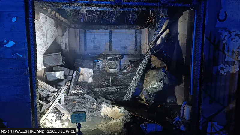

The picture of the fire, 1743506614628.png are you really saying the RCD did not trip? The news services love their pictures, ⁣ but1743506814032.png as to reporting if RCD fitted, or smoke alarm fitted, never mind AFDD, nothing. As to a report, Mr. X taken to hospital due to a fall in the ice while outside going to garage to reset RCD, it will only say he had a fall, nothing about why he was outside.
I have now put in handrails most of the way down to flat, where the consumer unit is. But there is still a risk involved resetting RCBO's at night. To fit AFDD to my mind not worth the risk.
