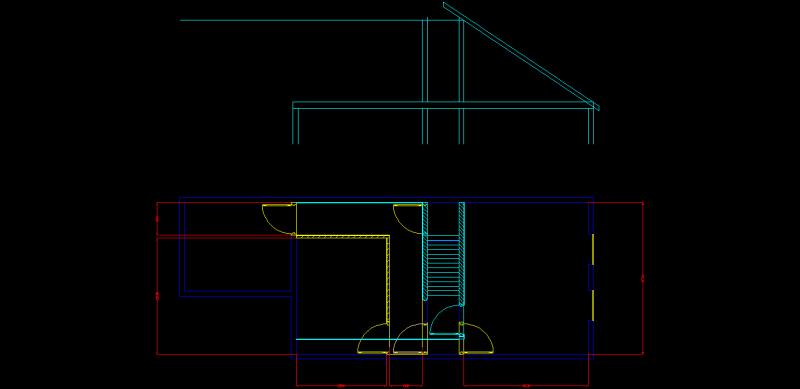

We are just getting the ball rolling for me to do with someone else doing the exterior of the dormer ( not something to hang about doing for a DIYer)
All with timber no steel work
Our plan is dormer on the rear bedroom off wall plate to virtually full width minus the chimley breast.( about a 3mx3.m room
Put up a corridor though the back bedroom to the rear bathroom
loft stairs above current Either using space savers as a last resort or a 90deg at the bottom.head hight going to loft roof
Once in loft over the rear room we would have a large room.
draftmans prior to SE said leave full loft as one room( full area of loft)
then split if wanted later for storage( only because i want a velux on the front for natural light and escape if it is separate would confuse matters)
This is my current plan yellow line showing the new corridor and new doors on 1st floor
Blue showing the dormer and loft stairs
