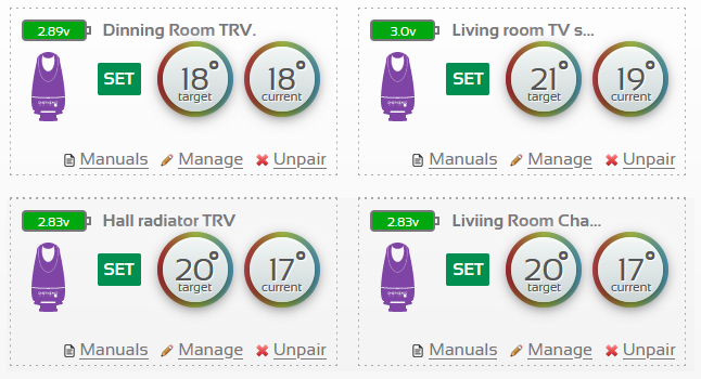

I got the Energenie first, which do show on the PC both current and target, did not work so well with an on/off oil boiler I have now, but with the modulating gas boiler I used the current and target reading to set the lock shield valve. 4 TRVs-1.jpg the method was if the current exceeded target to close lock shield a small amount. One set to be fair they were within 0.5°C of setting when used with a modulating boiler, and I moved them around radiator to radiator to set the lock shield valves, once all set those with old wax heads were also spot on, found TRV's work better on supply side, on the return there is more of a tendency to over shoot.
The eQ-3 only shows target temperature, so can't be used to set in same way.
