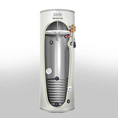

I usually fit Gledhill or Range Tribune when fitting unvented, but noticed this brand ( joule) use an air baffle inside ( Like Range Trubune XE or Megaflo). Making fitting a bit quicker. Have you fitted or worked on one? Plumbing Giant look the cheapest, but that often means damaged or late.
Megaflo suffer from air baffle break up, don't know about the others. OSO cylinders do use a internal air bubble but no air baffle, also, the dip tube can be removed and a external expansion installed which gives ~ 10/15% increase in HW storage.
