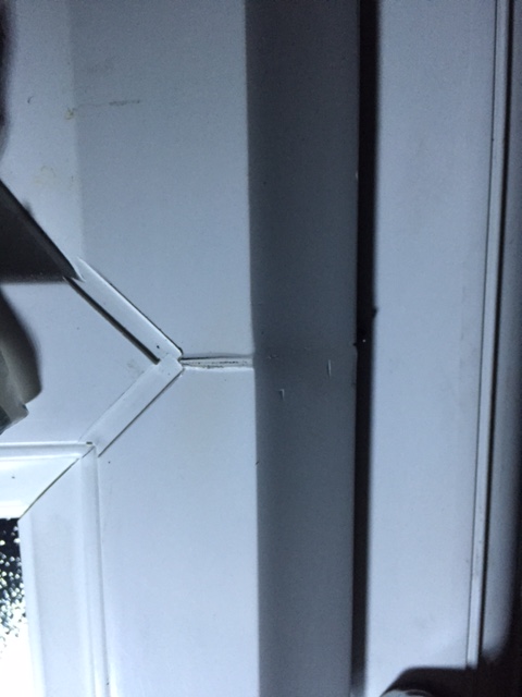

I have been planning to have new windows for a while and have finally gone with a local company who use a liniar frame supplied by a company called Truframe in Leicestershire.
The fitting started yesterday and two windows were put in. To cut a long story short we noticed some chips in the plastic and on closer inspection feel the window is not that well put together.
I don’t think the chips and scratches can be disputed and the owner of the company came around straight away and agreed that this was not good enough and would be put right.

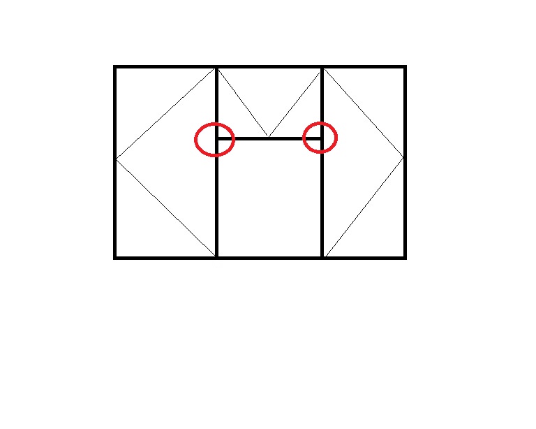

However I am starting to query the overall quality of the joins in the window and would like some advice.
Basically the window has three way joins where I have circled and the plastic is raised and quite rough. The Window manager is saying this is unavoidable on a three way join but I am not so sure. You can also see some chips on this part of the frame on the photograph.
Should I expect these parts to look like this?
Thanks in advance.

I know how you feel. Had similar issues with my windows. Mine were far better than that though. Crap joints! I even had the window manufacturers warranty guy & sales rep round. They did remiedial work but still not 100% happy. The window manufacturers excuse - "We employ foreign workers & most don't speak English!" How was that my problem!? Anyway, if you think Fensa will help you, they won't. They are on the manufaturers/fitters side (paid for by them!) Get what you can done by the supplier/fitters & then learn to live with it.
