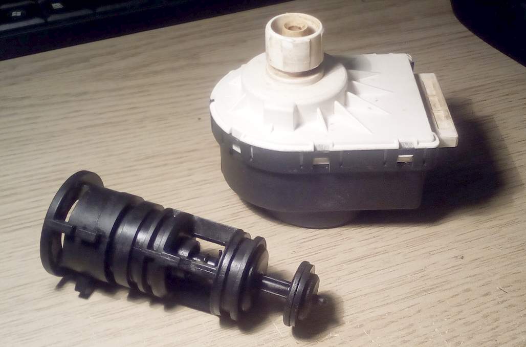

I replaced also the valve itself completely (pic #3) but the CH pipes still gets warm.

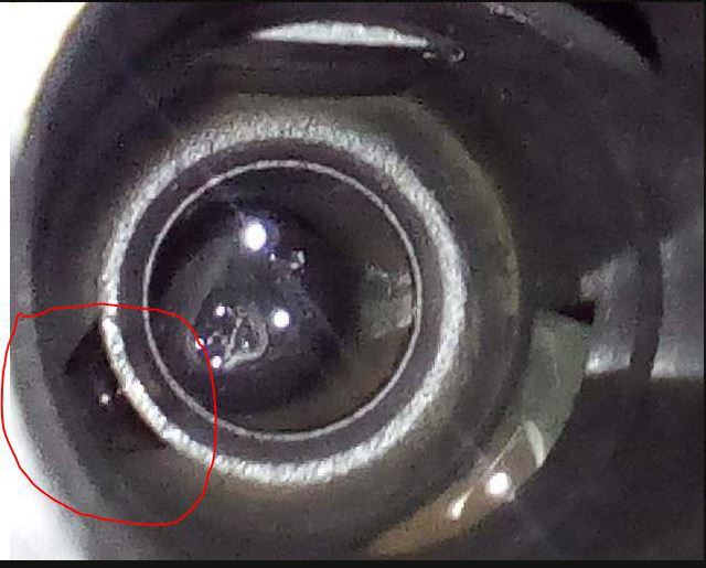

On the attachment #5 I made a picture of the house from above where the valve goes into.
It looks okay to mee, no damage, its clean.
How (where) can the HW get to the CH system...? Only here?
There is a strange little hole on this picture marked with red.
I dont know why but I guess it was there too when the boiler was perfect...

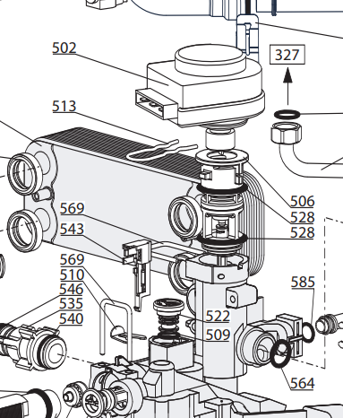

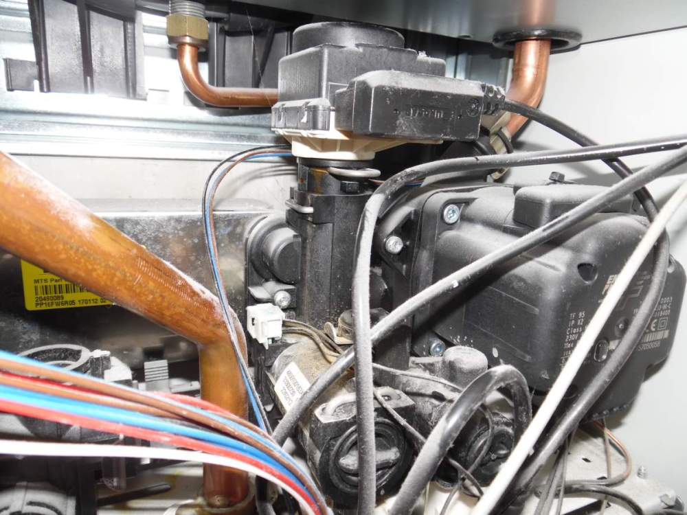

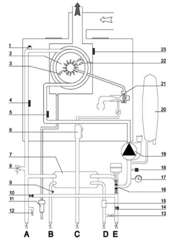

1 - inside.JPG 2 - scheme.JPG 3 - valve.jpg 4 - valve draw.PNG 5 - house.jpg

in your first picture it is obvious that the diverter valve cartridge is leaking and this will have damaged the actuator (what you call the motor) when replacing the cartridge it is common for parts to break up and fall into the housing, remove the actuator and make sure that it is actually motoring in and out just because you have voltage does not mean that it is working, note it does not motor in you will have to push it in with a screwdriver as the spring in the cartridge pushes it back
At the end I replaced both the valve and the motor as well.
I checked it outside before install them into the housing and they worked properly.
Is there any other path then the diverter valve?
This hole marked with red on the last image about the housing is normal?

Yesterday I succeded to fix the problem finally.
I had to add a few mm to the shaft and now it's working perfectly.
I don't get it why it wasnt working with the brand new valve + motor combo but that's life. :)
Thanks and cheers!
Where did you get the motor? Although these motors appear the same the stroke length of the pin varies slightly between variants.
