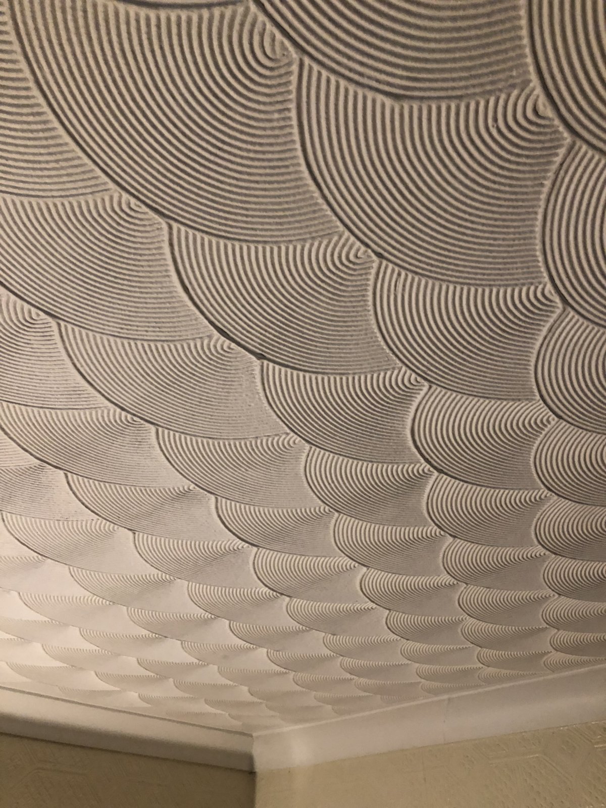

There is a lot of textured coatings, on ceilings and walls, it's like a huge, ugly meringue. As part of the process of bringing the house into the 21C I intent (want) to get rid of the textures.
Here is a ceiling:

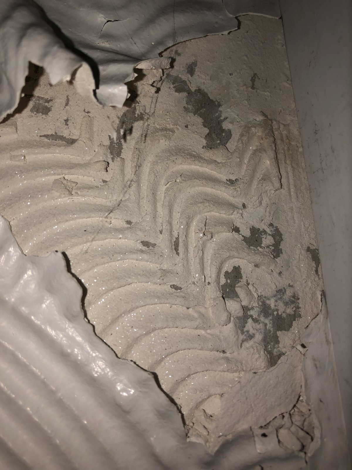

And here is the hall wall where some damp has caused the outer paint layer to bubble off, exposing the material under. It's hard to see in the photo, but the material is off white, about 3mm deep and contains lots of sparkles, like glitter.:

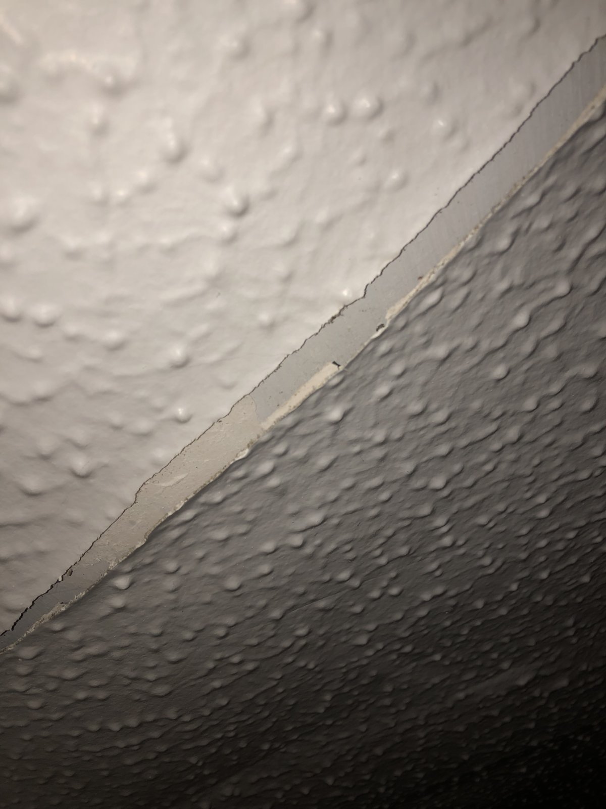

Another ceiling, I haven't looked too closely but it looks like a heavy woodchip paper:
My concerns are the artex looking materials. Does the glittery effect appear in asbestos carrying artex?

They all look like classic Artex to me including the "woodchip" one, they look professional so very likely to be genuine asbestos Artex rather than a DIY product. Testing is the only way to be sure though.
I have scraped and skimmed mine. White asbestos is minimal in ceilings, even spoke to a asbestos specialist who even admitted he would happily re-board his house if it had artex rather than calling his company in! I did however mask up when knocking the high spots off.
Thanks for the info. For the time being I'm going to leave the ceilings, patch over the dodgy sections then come back to them when I can get everyone out the house for a few days.
