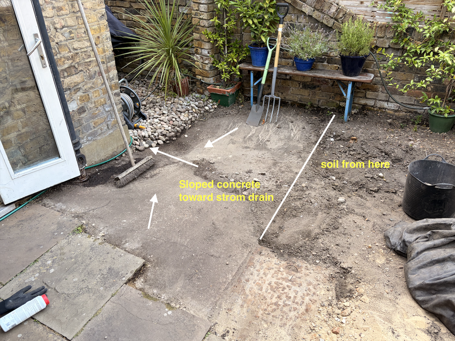

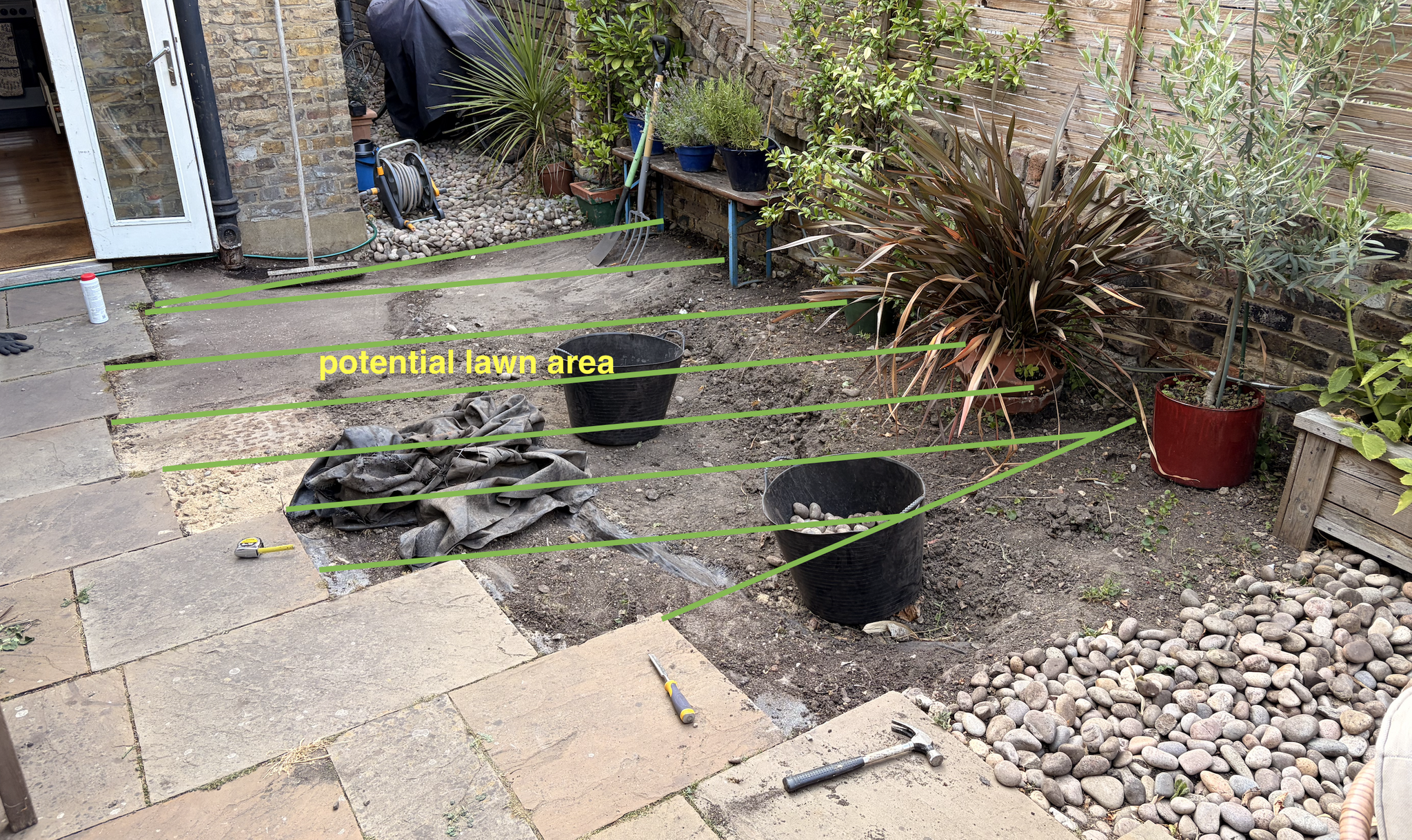

I'm going to bite the bullet and go for artificial turf, as it seems like the only solution where I won't have to smash out a slab concrete that backs onto the house.
Does anyone know if it can work across concrete and soil both without too many issues?
That said does anyone have any pointers when it comes to the best underlay options for artificial turf?
Particularly in this situation if its spanning concrete slab and soil?
I was thinking membrane then granite dust then another membrane, or something in that realm? As its a small area happy to pay for the premium artificial turf for best realism and feel.

I’ve replied in your other thread but if I was you and you are happy to pay for a proper job, get some artificial lawn experts round and see what they say. I think you may have problems laying it on concrete though.
