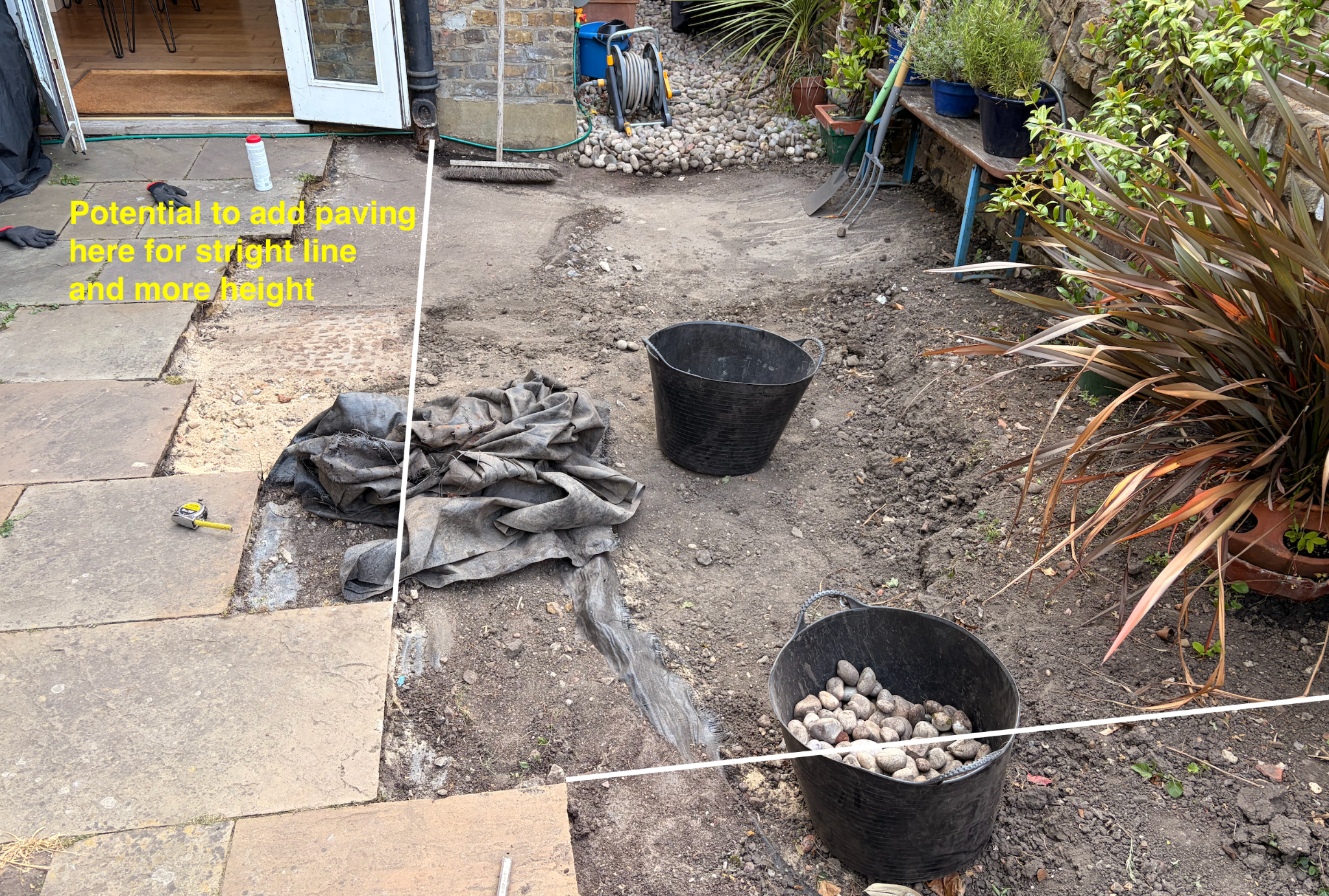

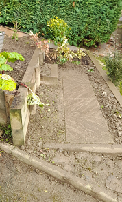

Hi all,
We’re expecting our first baby later this year, so we’re trying to create a decent patch of real lawn for the garden rather than leaving it as gravel. This area gets a good amount of sun and is the obvious place for it.
I’ve already excavated the existing gravel and soil, but uncovered concrete underneath for the first 3rd of the space.
A few key points:

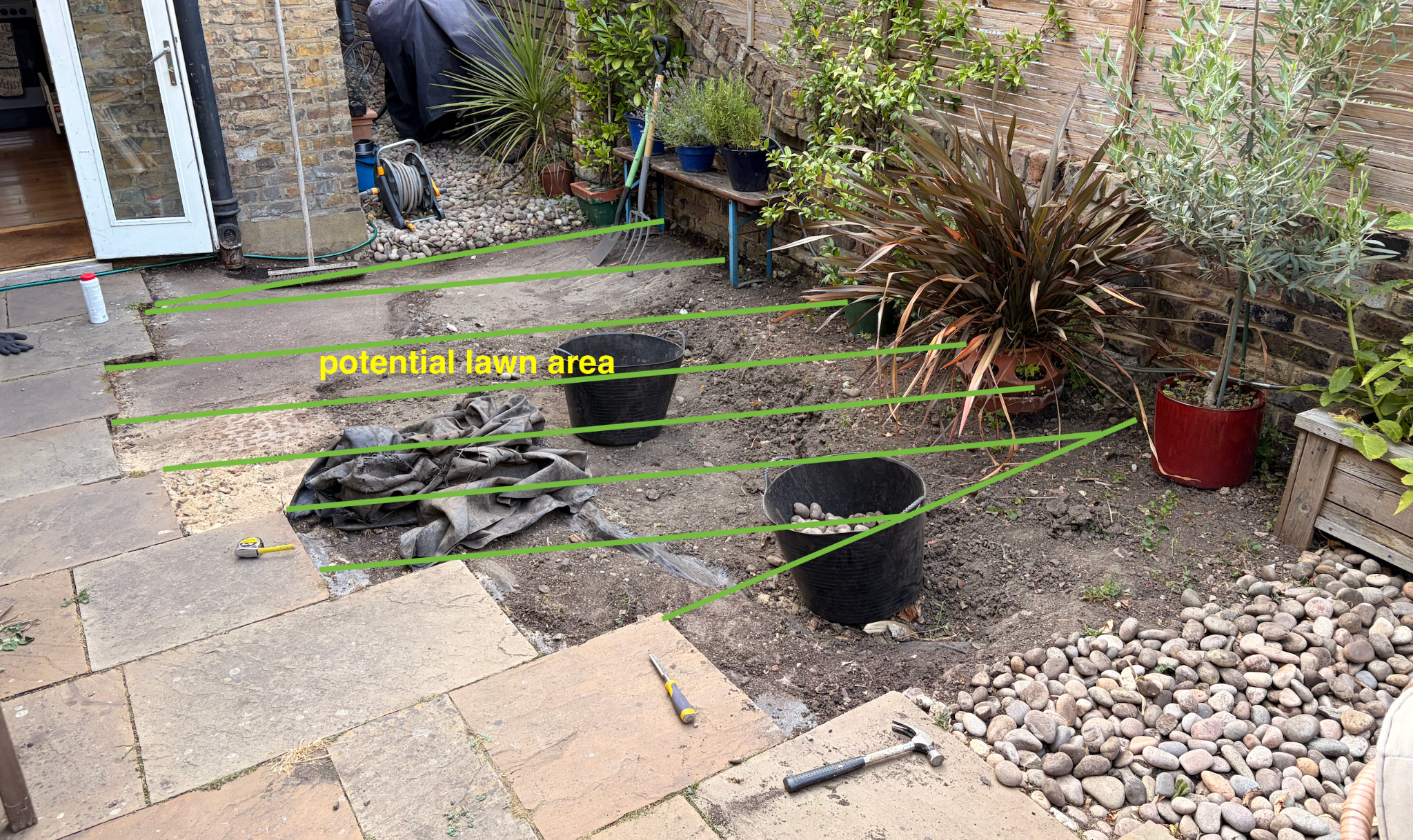

The area we’d like to turf is the one highlighted in the photos.
The slab only covers roughly the first 2 metres. Beyond that it’s normal soil.
The whole area is about 4m long by 3m wide.

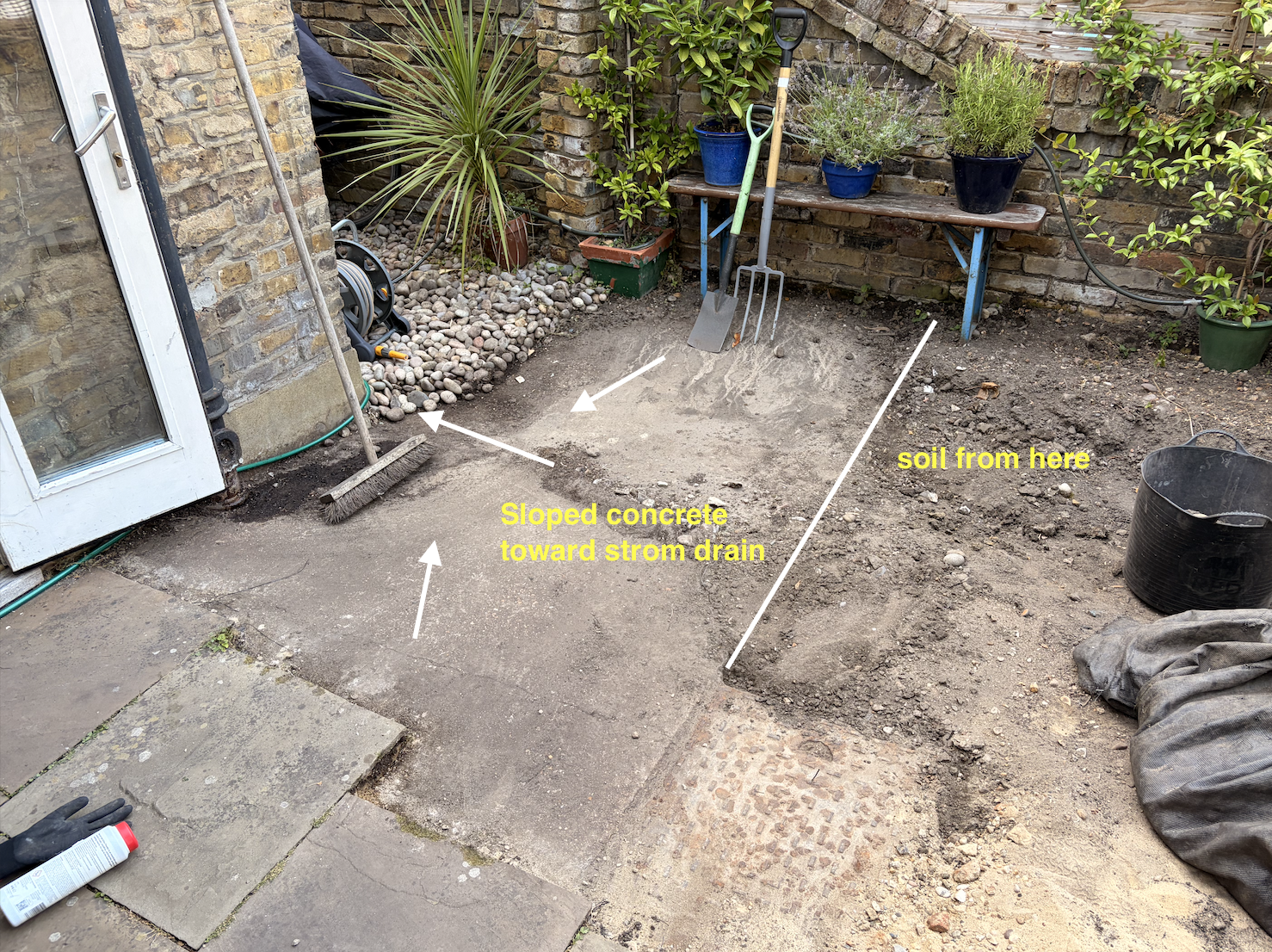

The concrete isn’t flat. It’s bowed, with the lowest point in the middle, and it also falls towards the storm drain that runs down the side of the house (just out of view in the photos). The whole garden slopes towards to house too.
There is also an old manhole cover, although I’m not particularly worried about turfing over that if it’s acceptable.

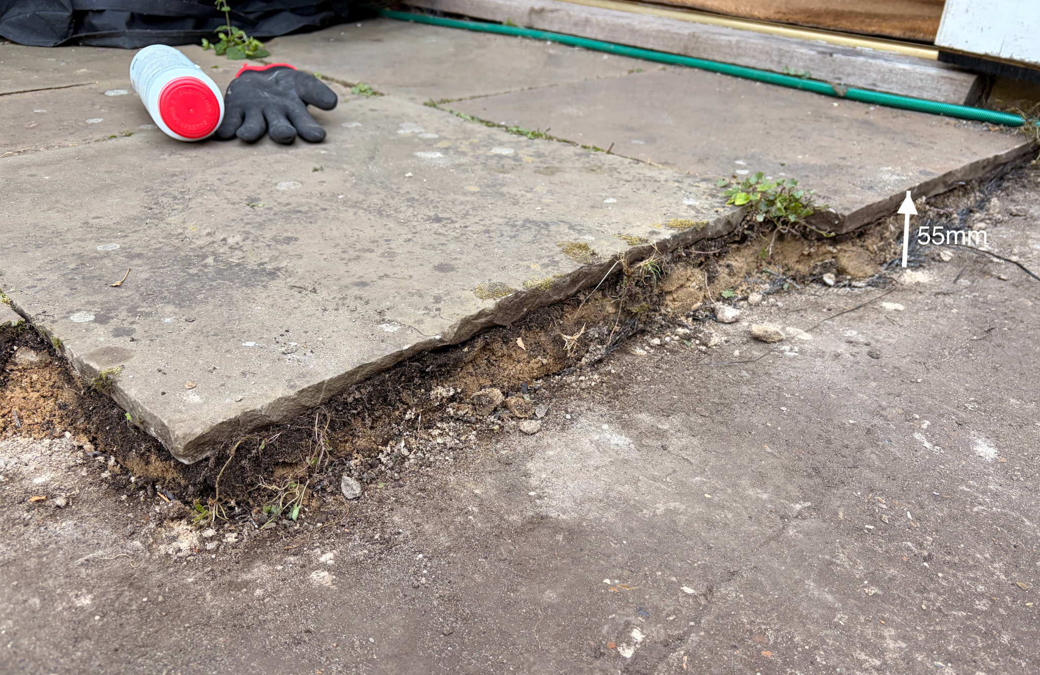

My main concern is that from the existing paving to the highest points of the concrete I’ve only got around 50–55 mm before the finished lawn would sit above the paving. I’d ideally like the turf to finish almost flush with the paving, but I appreciate that’s not much depth for topsoil over concrete.
So my questions are:
Is turf over the slab a terrible idea with only around 55 mm available in a few places ?
If you were doing this, would you extend the paving out slightly to create a straight edge and gain a bit more depth over the concrete?
Or is there another solution I’ve not thought of?
The only alternative I’ve really considered is artificial grass, but I’d much prefer real turf if it’s practical.
I’d really appreciate any advice before I order topsoil and turf. Thanks!

You cant turf over concrete. Plus, any manhole needs to be accessible.
The problem is the homes damp course, that limits height. I have planted on tarmac, but I have around 12 inches of compost on top of the tarmac. And I am not sure if that is enough.
With a sleeper boarder so the lawn is at least 10" above the concrete it may work. In the same way as old people like me have raised beds so we don't need to bend as much.

Setting turf atop concrete isn't a good idea, and in an area as small as that i'd settle for a rockery, raising it up with several levels of natural stone, seeded with suitable plants and moss - if you really want a lawn, make it in the center of your plot on a raised bed for added drainage where it'll receive more sunlight.
Although on a bed of 50cm soil and then the turf it will work untill you get some dry weather and it will dry out very quickly, way before the the rest of the grass. I would slab over the concrete and put the grass further up. You actually are better off slabbing the area directly outside the back door
Thanks for all the feedback everyone, really helpful. I'm going to bite the bullet and just go for artificial turf, it seems like the only solution where I wont have to smash out the concrete and can work across concrete and soil both without too many issues.
That said does anyone have any pointers when it comes to the best underlay options for artificial turf if its spanning concrete slab and soil?
I was thinking membrane then granite dust then another membrane, or something in that realm?

My next door neighbour had artificial turf laid more than 10 years ago. From what I observed, it was a major job involving several layers - sand, type 1, barrier membrane, more sand etc to a depth of about 8”. Looked very real and still does. On the other hand, my mother in law had some cheap stuff laid and it was complete rubbish. It crackled when you walked on it, the window cleaners ladder left dents in it that never sprang back and it looked like a greengrocers shelf! Within 2 years it was full of weeds and curling up at the edges. If you are going for artificial, get the best you can afford and get it laid by a professional company that has been recommended.
