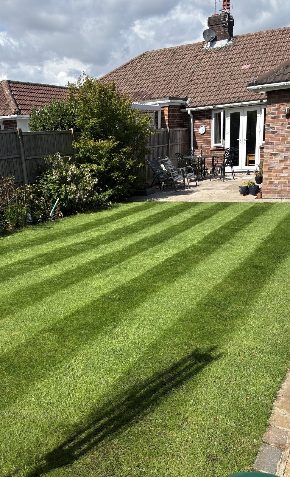

Follow the process. Watch Daniel Hibbert & Lawn Right on you tube. Mine was originally turfed 5 years ago but has been overseeded the last 2 years. This was taken in September and it still looks good now.
