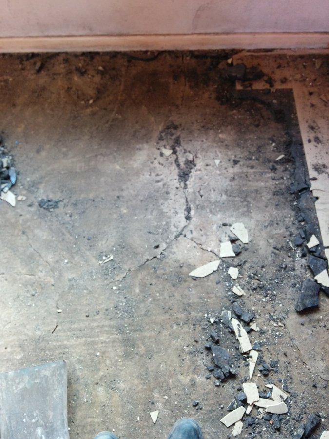

There are a few similar posts in the flooring section but none have any usable solutions so I thought I'd try in here!
I've taken some patches of the 20mm deep asphalt coating in a room (The patches are now down to concrete)
I need to fill them in again and I am struggling to find a suitable product, the criteria is: Damp proof; Able to work within the 20-25mm available depth; Easy to level and finally it will also need to join and seal against the remaining asphalt edge.
I can't really find anything suitable. Pot hole repair stuff come to mind but I'd rather have something that I can pour as some of the areas are quite big.
Re-asphalting is obviously an option but it seems to be rarely used in indoor flooring these days and I suspect it won't be cheap!
I also wondered about a liquid damp proof down on the concrete then some other self leveling above that.
This picture is stolen from another thread but its the exact same stuff - only I have bigger areas to fill!

There are asphalt patch repair products you can buy. I think 25kg is about £80, so it depends on the size of the repair.
Getting an asphalter in is the best repair, but even for a small job it takes time to set up the pot so it normally won't be cheap.
I would look at putting in a suitable liquid damp proof membrane, ensuring it seals into the sides. Patch the hole up to existing floor level with a screen mix, and if necessary, some self levelling compound over the top for a level finish.

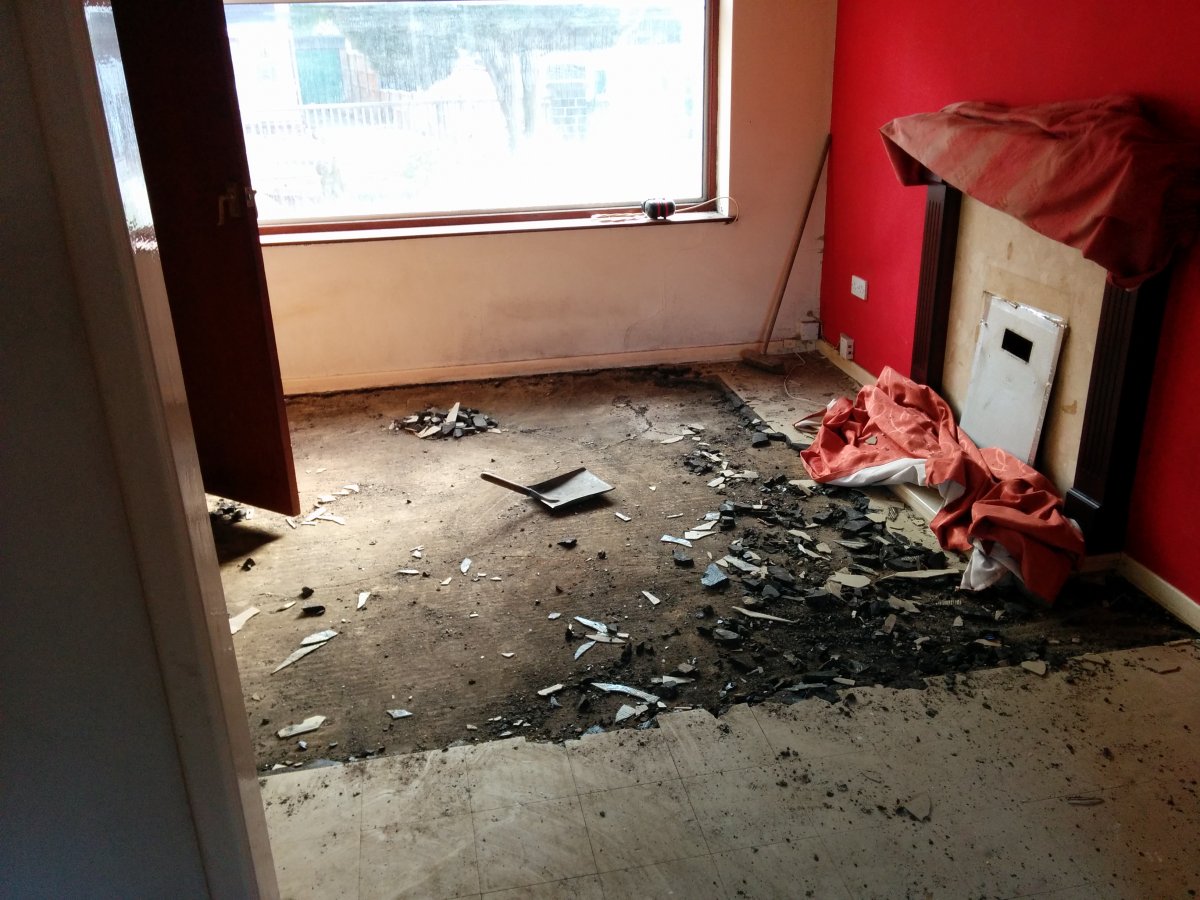

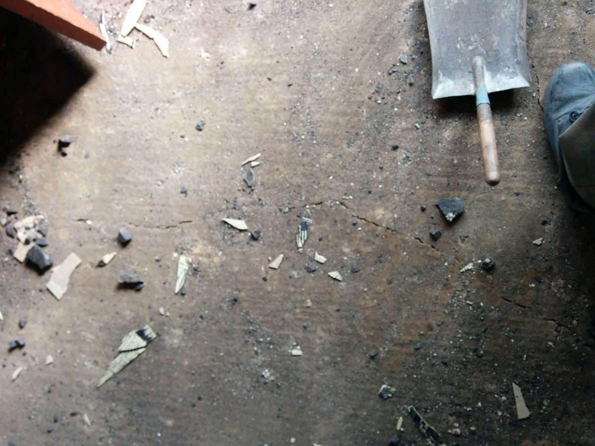

Yes it is the floor with the sulphate heave. Really unsure about what to do with it. I don't want to bodge it but equally I don't want to spend £*000's if not absolutely necessary.
I'm guessing by that comment that you would be digging it out Nige?
I've spoken to various other people, most peoples floors are completely fine. Some peoples are a bit un-even as per this one. Two houses, out of maybe 80, have had it dug out. One is the one that I am attached to!
Had a builder who has done a lot of work on the street have a look and he didn't seem concerned by it. He did point out it could get worse quickly or just remain a bit uneven for many years.
I've attached areas showing the floor and the cracking and also the area I'll need to level if I go down this route

No, once is enough. Yes if it was mine I would dig the lot out and reinstate with insulation and under floor heating throughout. But I would have to take expert advice as to how much depth to remove and the exact infill to use. Simply because walking on a bumpy floor would be unsettling to me.
