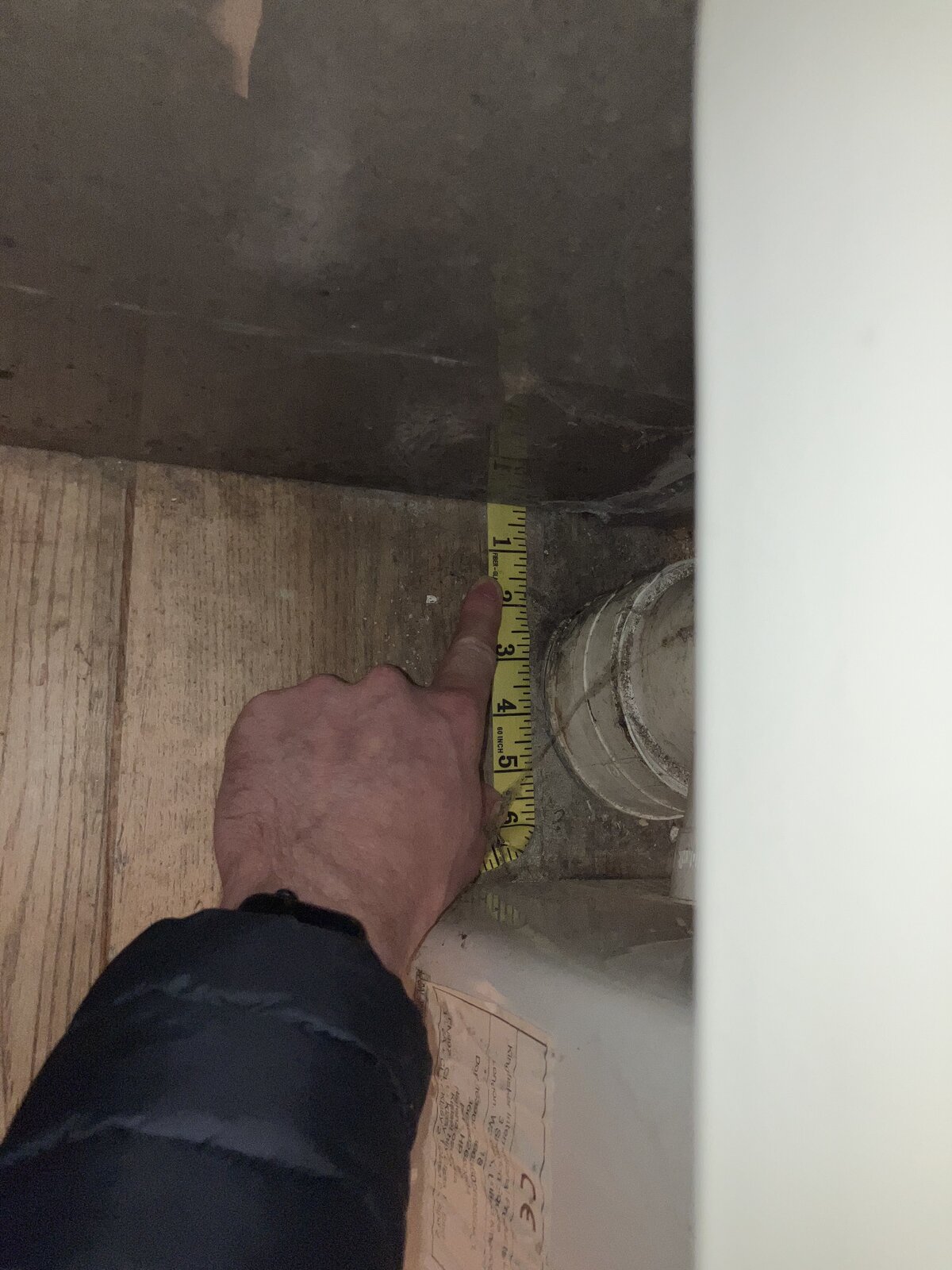

Hello all,
I am looking to fit a toilet with a built in sink in the top of the cistern. I have attached a photo of where my waste lies in the floor. I can’t find any that will fit in my opinion and it shows the waste outlet as 90mm from the wall where my waste in the floor is around 95mm to centre point.
Any assistance welcome
It would depend on the wall to centre using a connector and then centre of pan connector to the toilet spigot. As the 95mm refers to the lip of the toilet spigot
