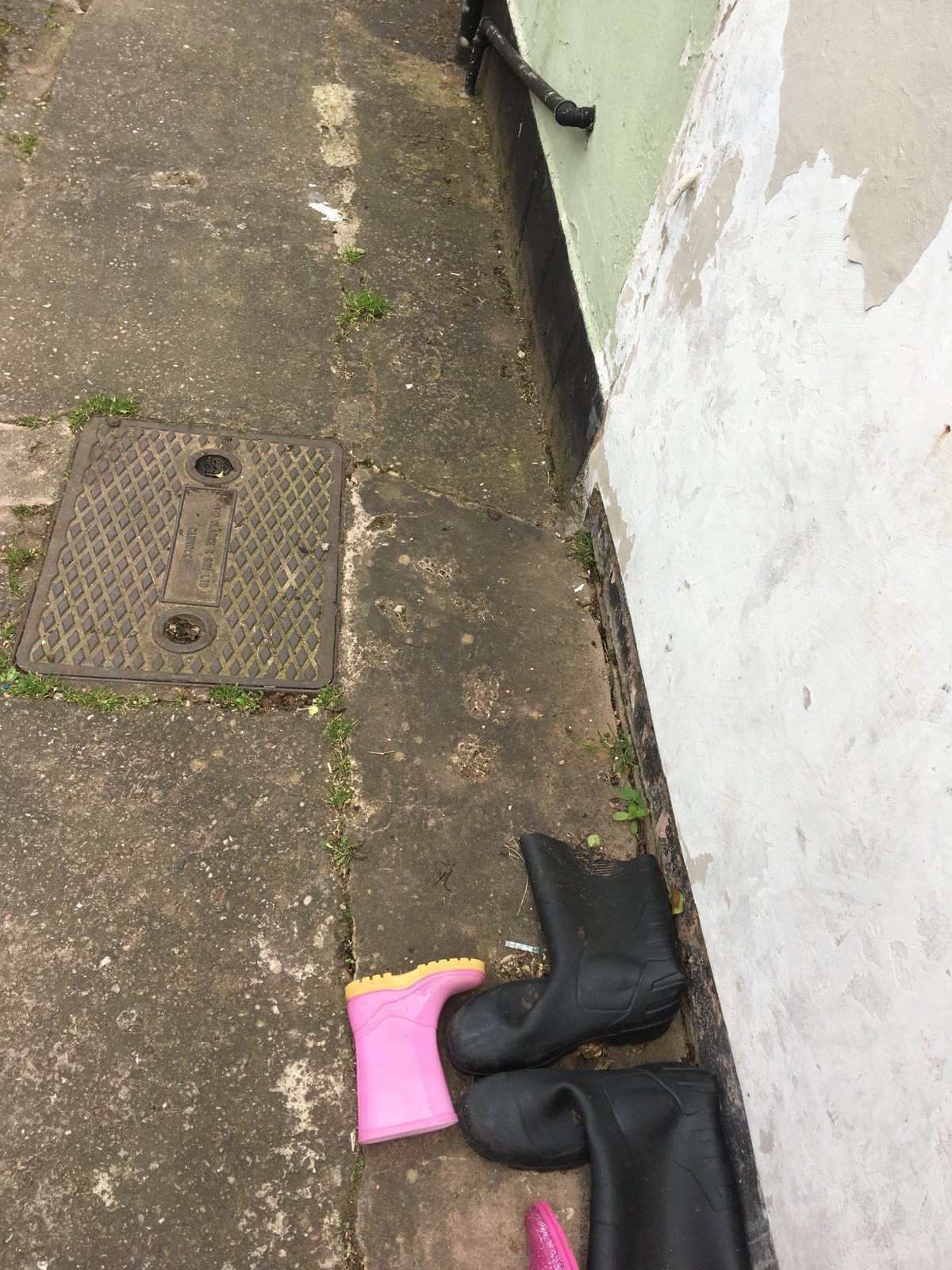

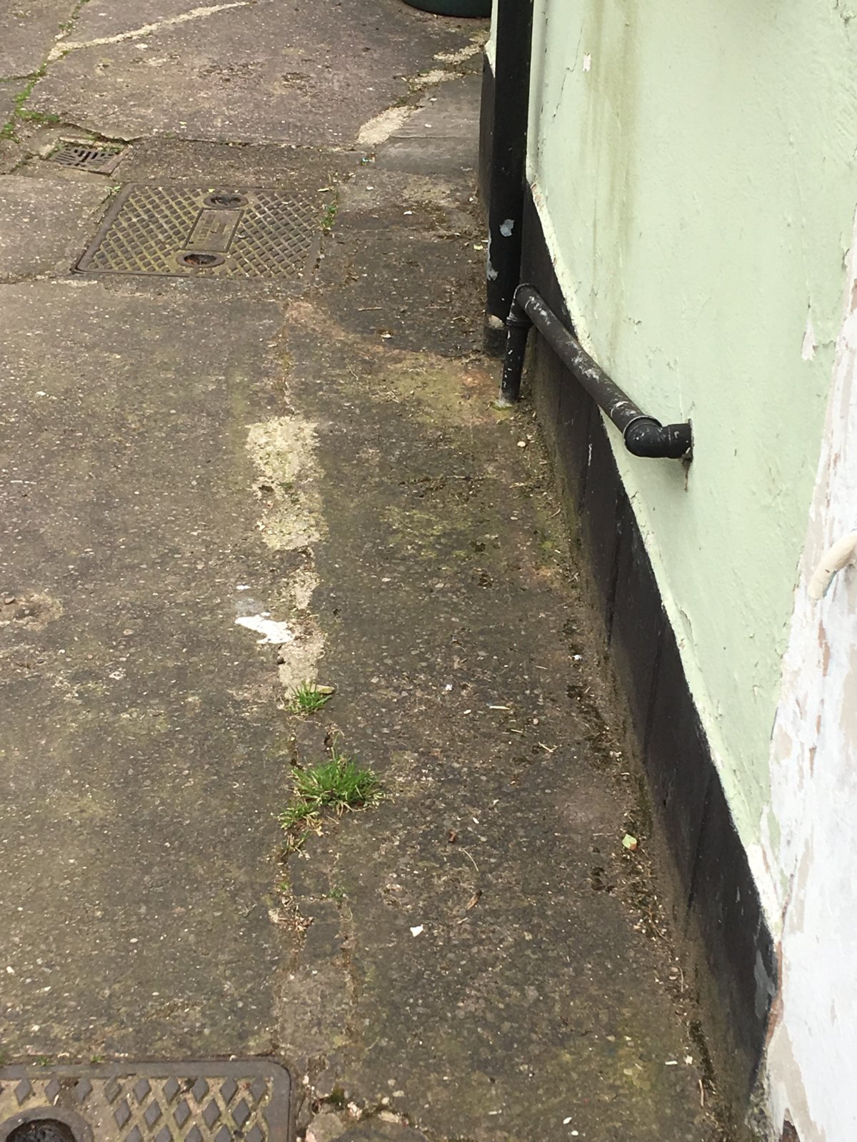

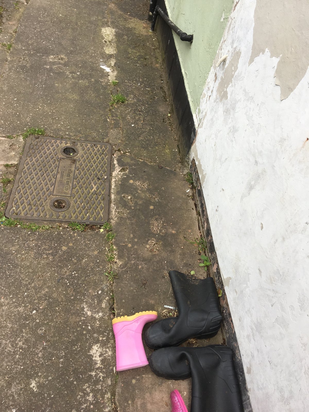

Hi there.
We are looking at changing our utility back into a downstairs toilet. Years ago, we removed the toilet to have the space as a entry type area. We have now realised that a downstairs toilet is worth far more when it comes to moving.
The waste for the toilet is in the floor and so relatively simple to re-fit a toilet.. however, I can not recall if there was a sink in there. Ideally we would like one, but with nowhere for it to drain I don't really know where to route the waste. Im guessing that sending it into the floor with the toilet waste wouldn't be really an option - unless someone has any idea how I could attach the waste from the sink into either the toilet waste or into the manhole for the waste itself.
Other option is to leave a sink which wouldnt be ideal.. so basically.. any ideas how I could route the waste from the sink into the toilet.... with no stack to put it into.
Ive attached pics to show how close the man hole is to the outside wall where the toilet and sink would be ... the 2nd pic shows what appears the neighbours have done and sent it into the floor and into the manhole.... is that acceptable to do??

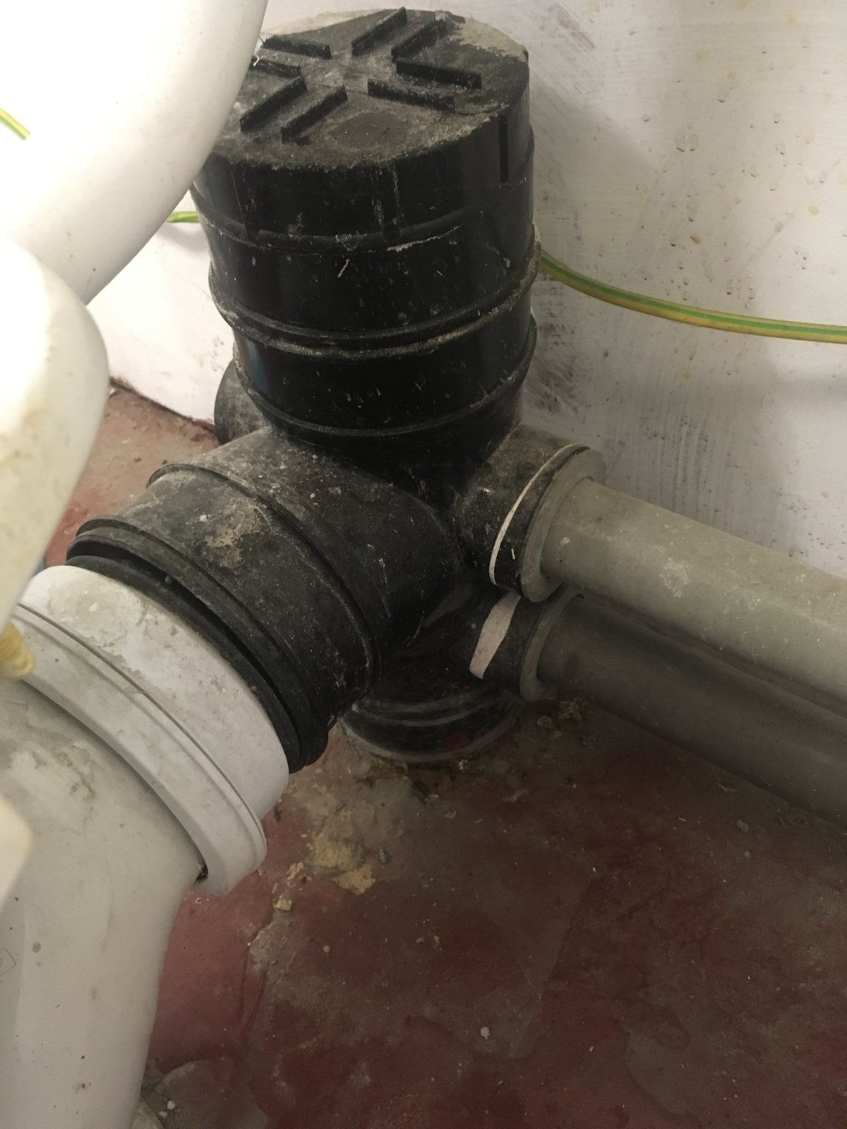

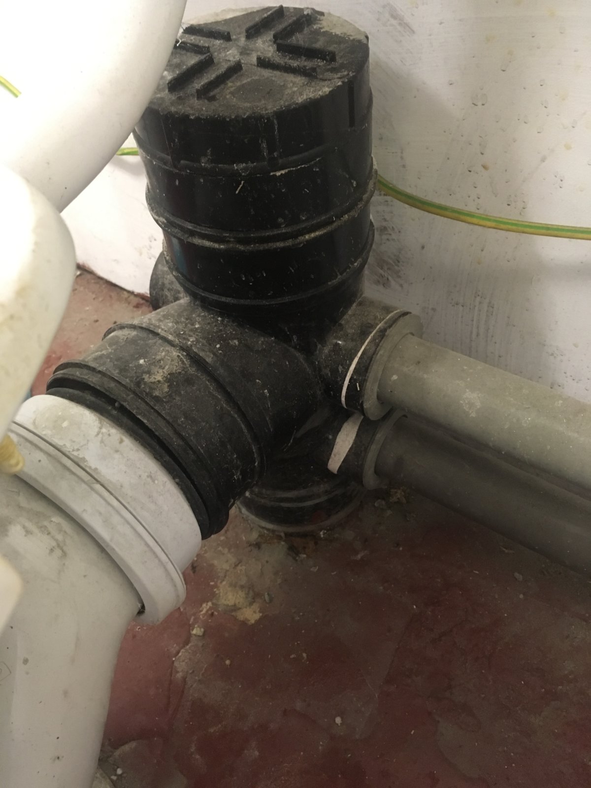

Something like one of these? I have something similar in my workshop - takes a sink and washing machine waste.
Would be a good idea to use an antisphon/self sealing trap in the basin if you're going to use the pan connector fitting.
This is what we have in work. Top pipe feeds three sinks/basins and the bottom one a washing machine.
