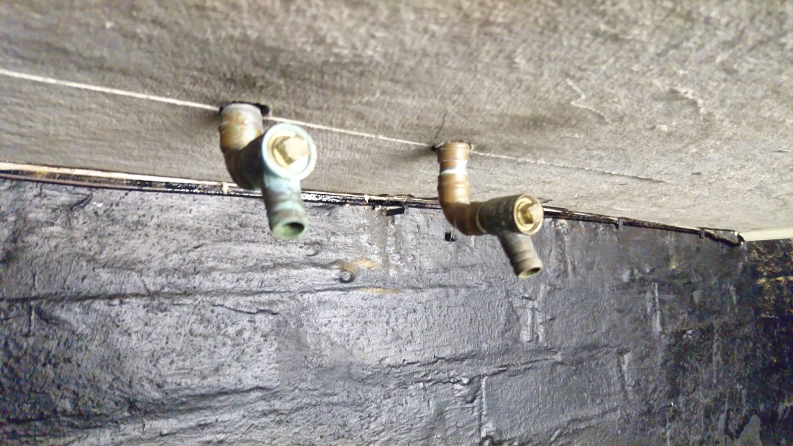

Basically I have a cellar and I'm trying to add a radiator to it to make it a useful space.
There are 2 drain points in the cellar ceiling.
Both get hot when the heating is on.
There is very little space between the fittings.
Could I just drain the system and attach a radiator?
Would it need connecting to both or one if the points?
Is there a rough price the job is worth for a plumber?
Any guidance would ge great

Thanks. Appreciate the response. Does one of the pipes go in the radiator and the other out? Does it matter which way they go round? Thanks
It's a parallel curcuit, but effectively, yes.
It does not matter which way round as long as the trv is reversible (use a Honeywell Valencia).
