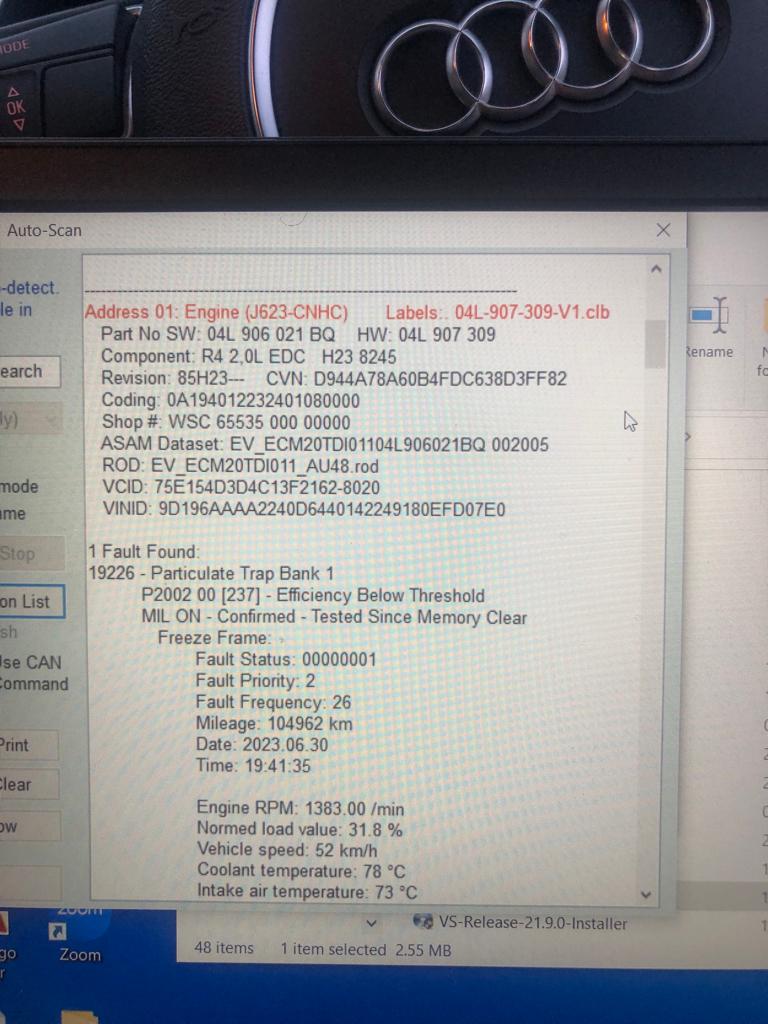

Hi All,
Some advice please;

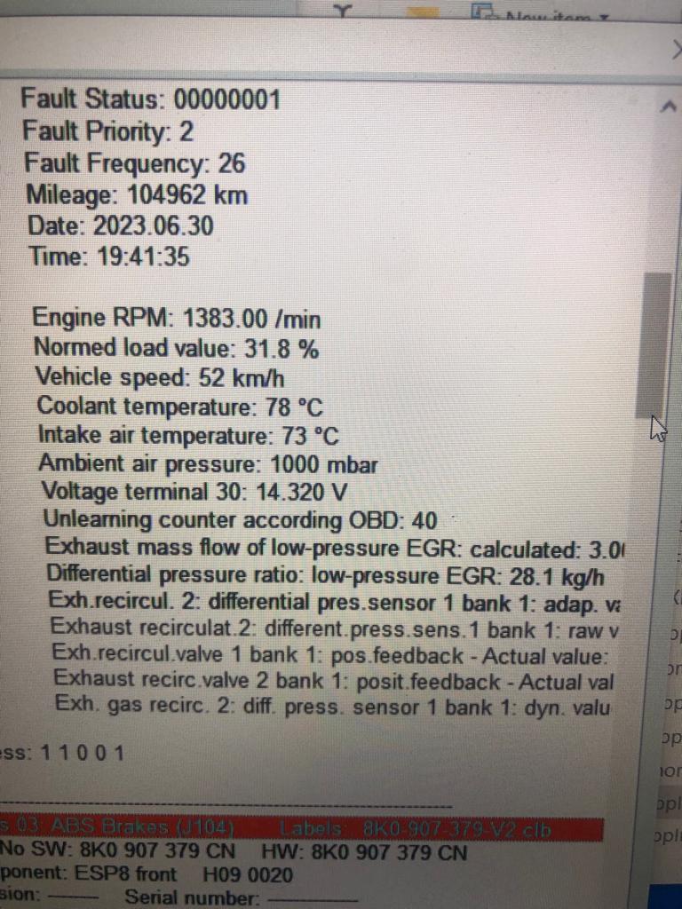

I have been doing a few short journeys however a couple of weeks ago engine management light came on but no DPF warning light. I ran the codes and got the same code as the pictures attached P2002 code. I cleared DTCs and the engine management light went away.
Couple days later engine management light came up again. This time I filled the car up half tank and took it for a hour motorway run. Code went by itself. Again a couple days later less than 100miles of short runs it came on again scans attached are most recent.
Any advice would be greatly appreciated
Kind regards

As above really......there is a pressure difference between the inlet and outlet pipes of the DPF which would indicate a blockage.
There are canned mechanics available, I can't comment on how successful they are but nothing beats removal for cleaning or replacement.

There are quite a few mobile guys around these days offering diagnosing/cleaning services so I'd maybe look at one of these that see all the problems, egr valves can cause codes like this too.
A lot of people go for "egr and dpf solutions" but I won't elaborate on those!
