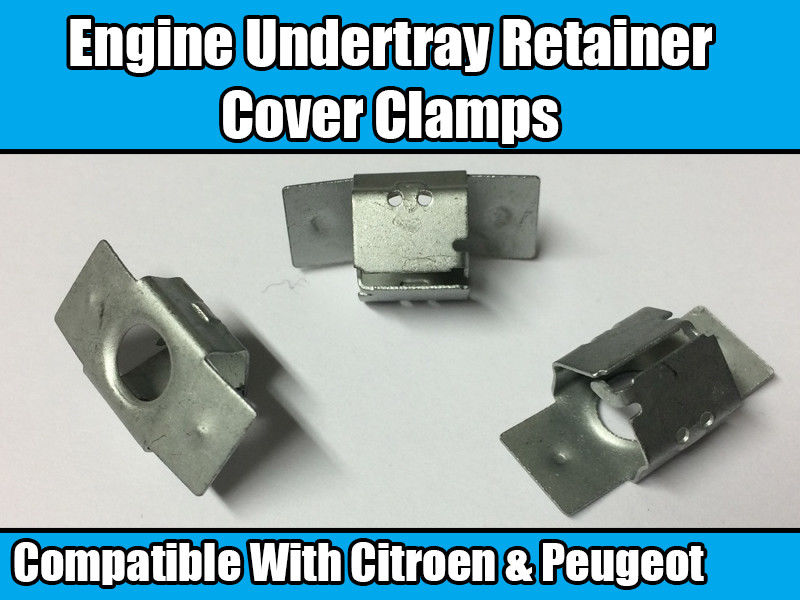

I think the French have the last laugh over us, concerning these.....(New Citroen Berlingo starring here)
Rectangular slots in a hollow front subframe, inserted in the slots is a square nut with its own captive cover that sort of clips into the slot (cant remember the name of them)
Undoing the screw causes the nut to jump clear of its clip and spin within the subframe. To make matters worse, the screw is in a deep hollow of the undertray moulding and the heads are hardly visible :eek: so they cant be ground off, and drilling only spins them :(
Oil change sir? That'll be 3 hours labour then (n)
John :)
Are these the clips John?
