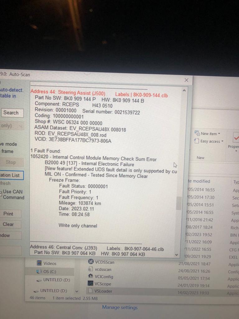

Please see error message from VCDS which is
Power Steering Assist 1052420
Steering assist J500
Internal control module memory check sum error- internal electronic failure

Dear All
Please see attached the Fault found by VCDS

I got the same error yesterday.. How did you solve this?.. I can´t find the module and not sure how to fix it.. only the light came out and not really any difference in the car handling. Thanks a lot for your help.
HI Acorana2
The Module is on the steering rack. Had to source the Electronic Module and then have it re-programmed. This fixed the problem I had.
Costs approx £600
