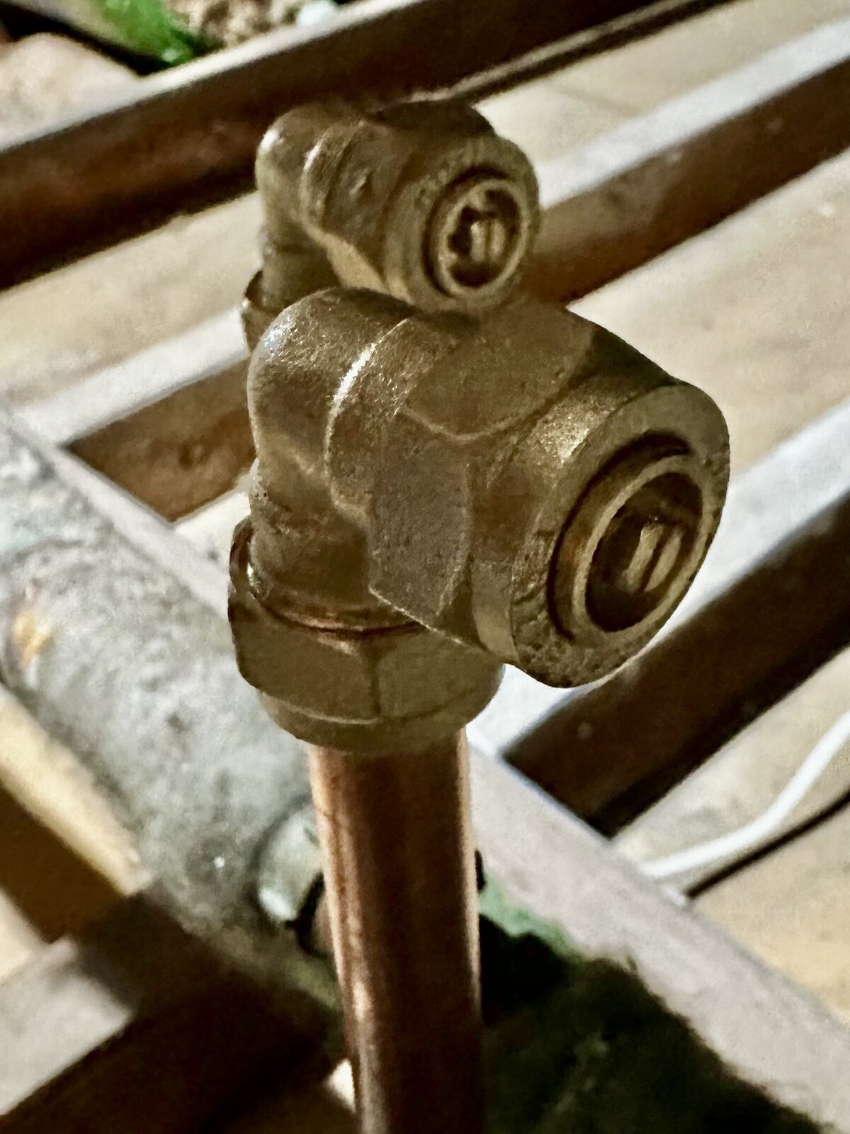

So I’m thinking I could cut off the bottle vents and use either this or this.
Is it sensible to incorporate a 90deg elbow so vents are horizontal ?
(to get a receptacle under them to catch water when bleeding)
Thanks D
Thanks for advice.

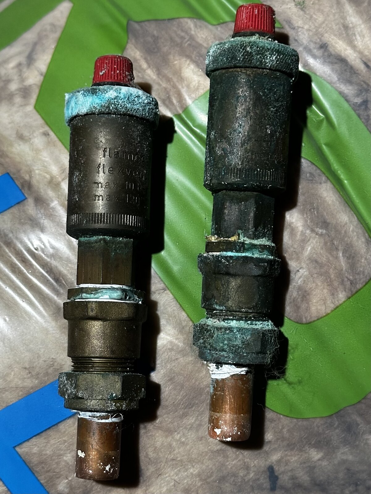

Removed / replaced the aged auto valves.
D
Ah, they were already Flamcos, doesn't look like they've leaked though, just a bit of surface corrosion probably from condensation.
Some now I believe can be removed for cleaning without drain down or the need for a isol valve, like a lot of shower filters which can also be removed without isolation.
