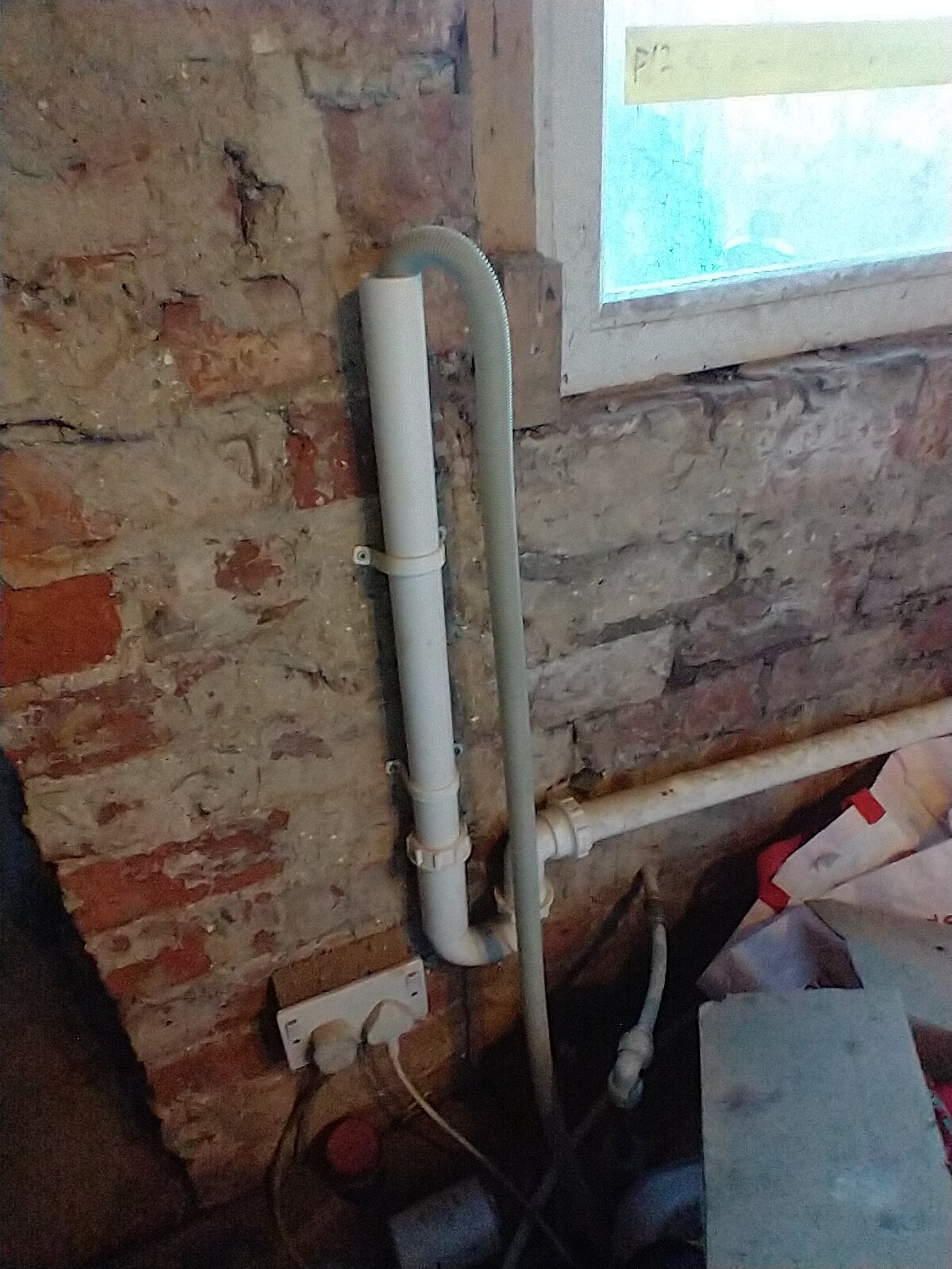

Here's mine. The only gurgling comes from the actual dishwasher itself, zero odours.
Use a standpipe, it can be cut down a bit but dont go mad, or it could overtop if crud buildup reduces flow capacity over time. If you cant get sufficient height, then you will need to look at putting the waste lower to provide the required height.
You need an air break between the outlet hose and the waste, hence why a either a standpipe is used or discharge into a sink trap is made above the water level, otherwise dirty water could re enter the machine.
Thanks everyone for all your replies, looks like standpipe wins 3/3 so that’s what it’ll be. I’d have to chop it down to about 21” above trap water level but assume that’s ok? I’ll obviously ensure the flexi pipe doesn’t jump out or dip into the trap water.

Use the plastic 'U' shaped former that should be supplied with the machine, hook the hose into the standpipe and it should remain firmly in position.
