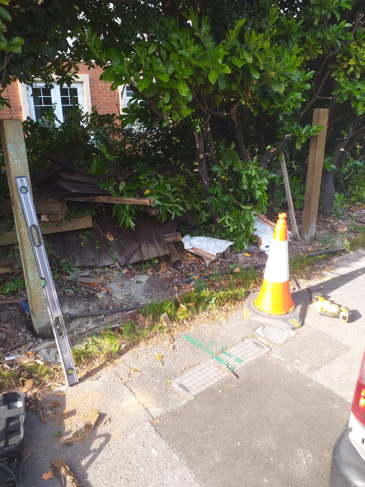

I know u look for paint marks to see if a pipe is running towards your hole (for example fence posts)from pavement. In top photo my hole is 500mm to left of sewer pipe line
Is 500mm to left or right of sewer pipe line ok to dig?
Anything else to look for where pipes are located?
I put two of my posts either side of water meters[
I dont want to drill through pipes.

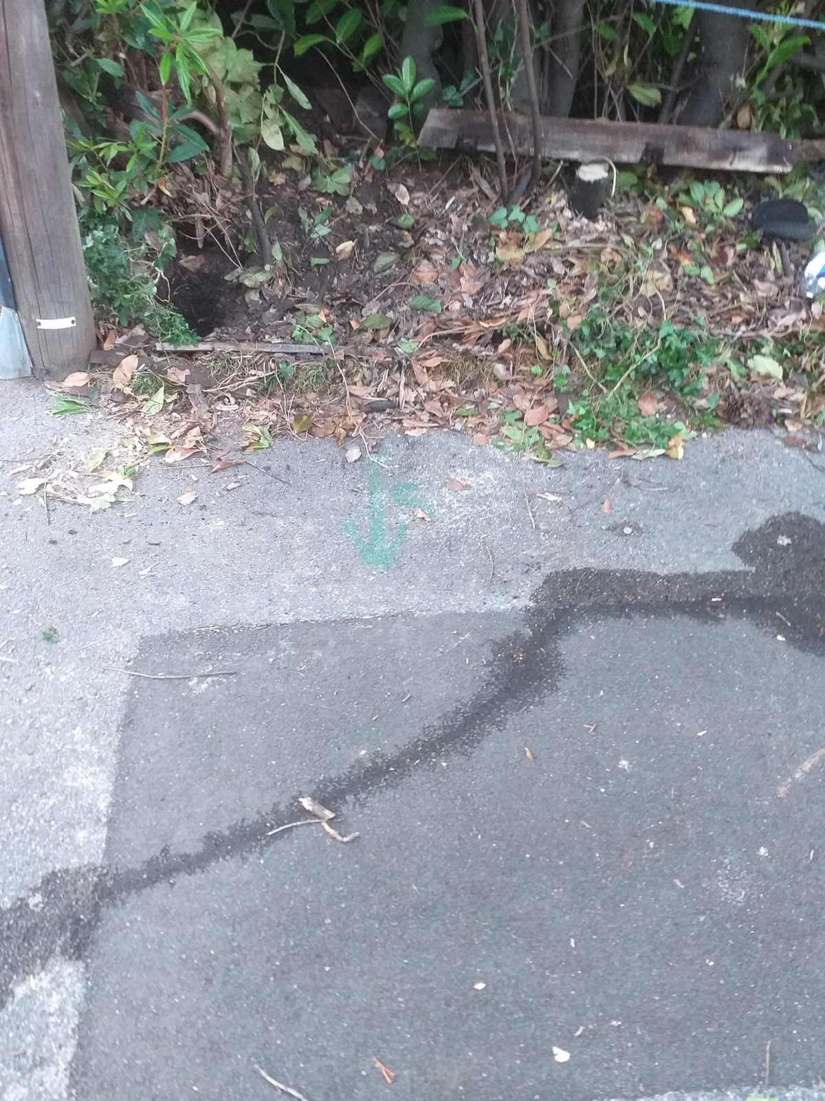

Is that wet patch on the pavement caused by the dodgy builder mentioned in the building forum ;)

Hard to tell, even the utility companies won't guarantee where things are. I would dig - just go easy and keep checking, especially next to a pavement.

Manhole covers, water meter covers, old asphalt tracks etc. It really doesn't get you anywhere though, who knows what is buried and unknown next to a pavement.
Dig slowly and double check as you go.

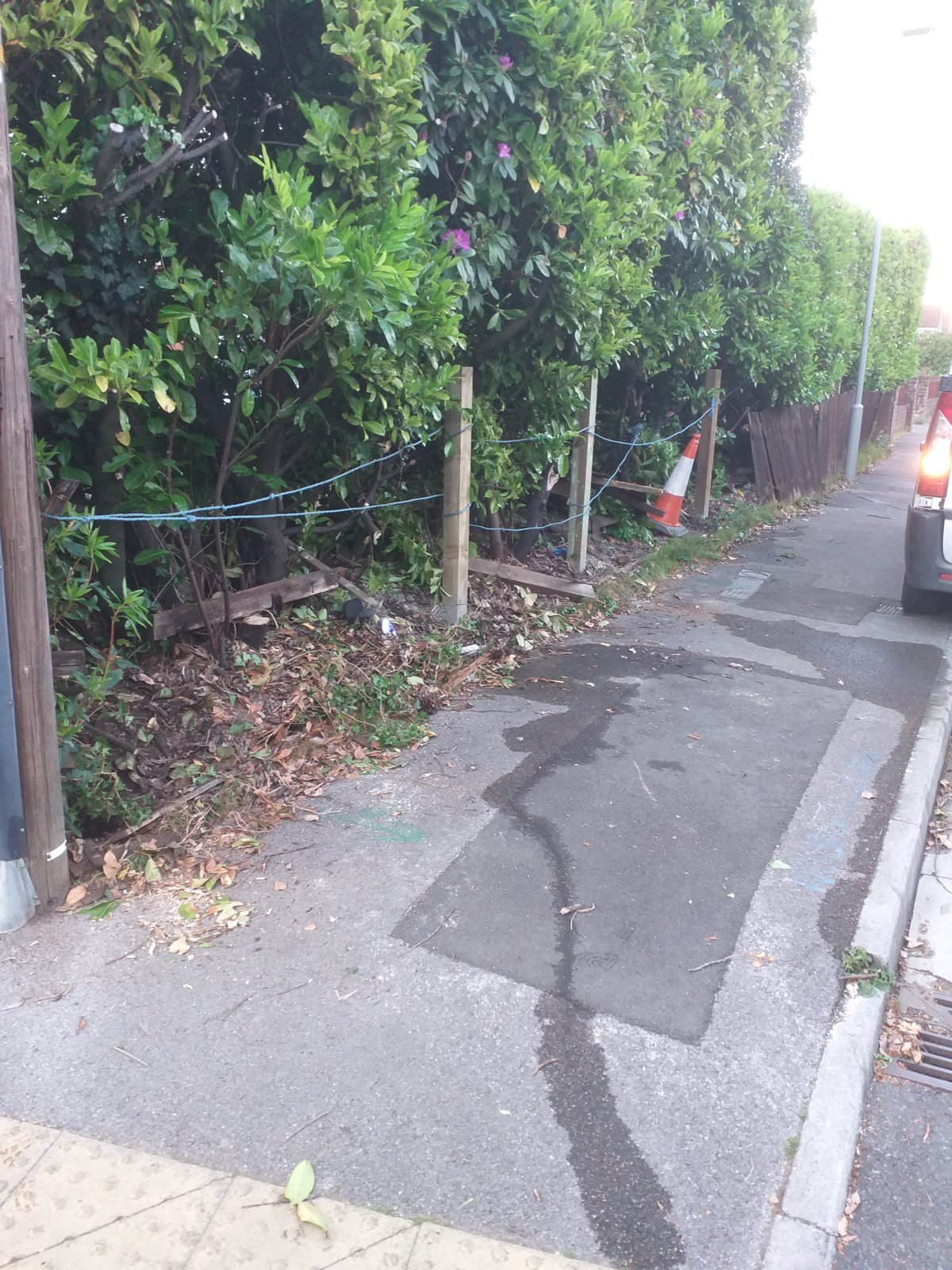

Look or ask the property owner where the services are in the property. Sewers run in fairly staight lines between manholes. Mains water and electric cables are not so easy. For the water meter, you can look under the cover to see which way the pipe is running.

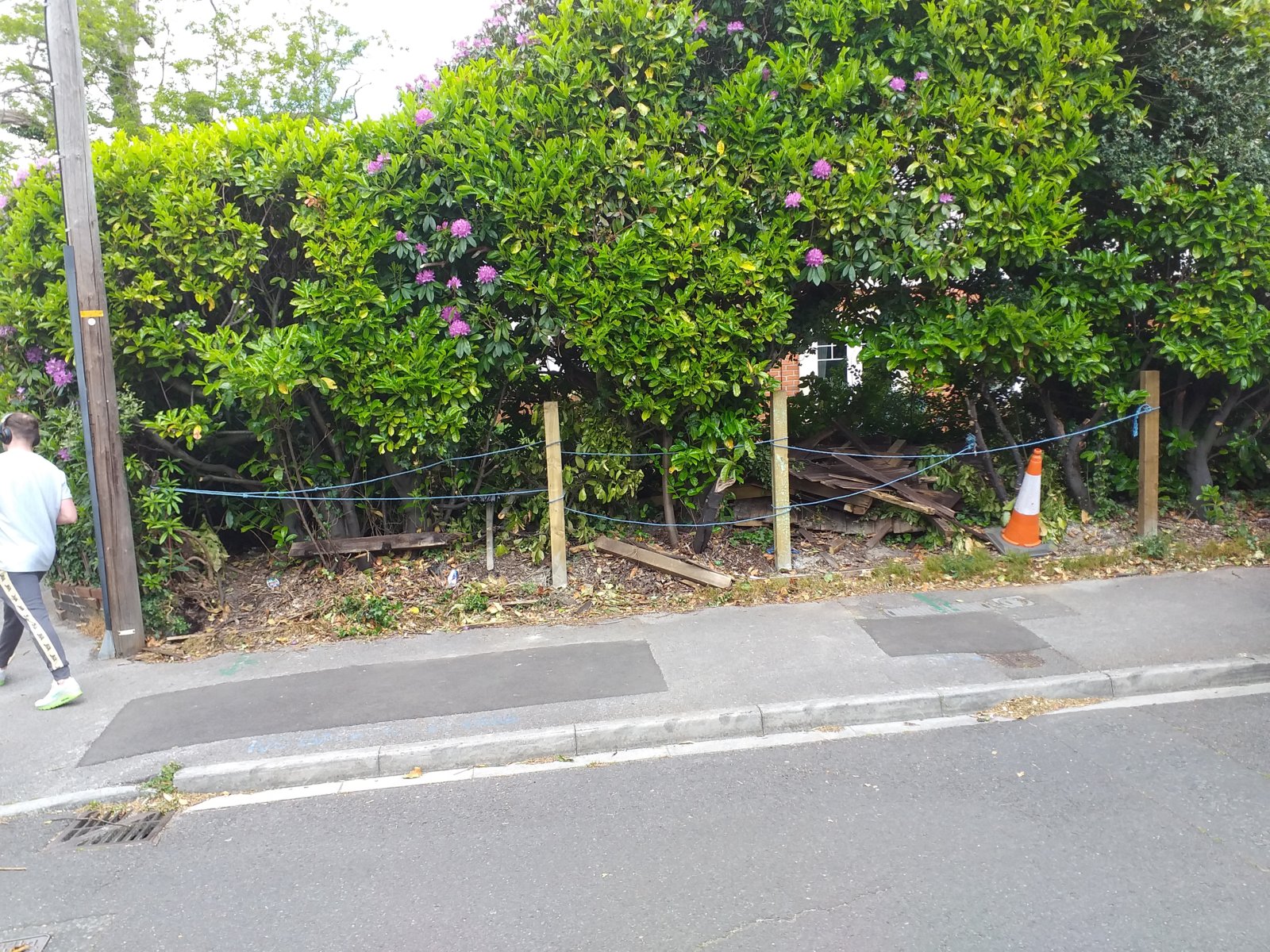

Seems you have the lot here - a telegraph pole and a lampost as well as the normal stuff.

I was going to put a post right next to the telegraph pole (theres walls foundations) next to it and very near a lamppost. Surely there are no pipes or wires in the garden near these two places?
I guess leave the breaker if possible and go slowly with metal pole or spade
U can see the posts avoid the ends of the new tarmac on the right but not on left.
I'm sorry but no one here can possibly tell you where to dig. Put the posts where you think and just be careful, dig slowly and carefully especially close to a pavement, telegraph pole and lamp post.
