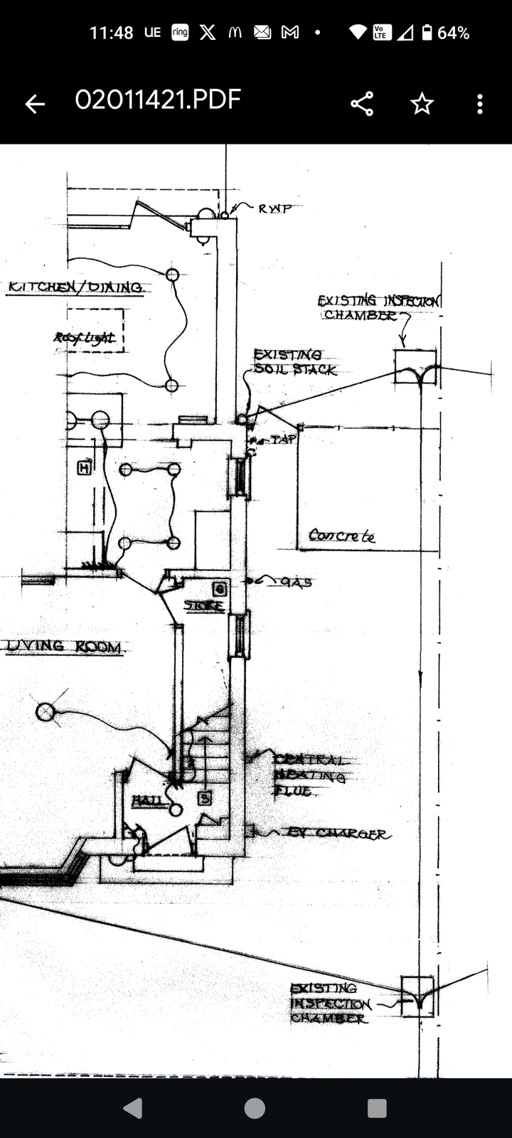

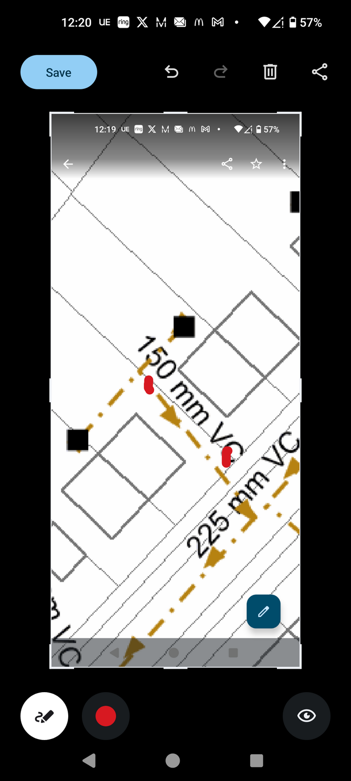

Advice Request: Underground Soil Pipe Running Along The complete Length Of The Footings.

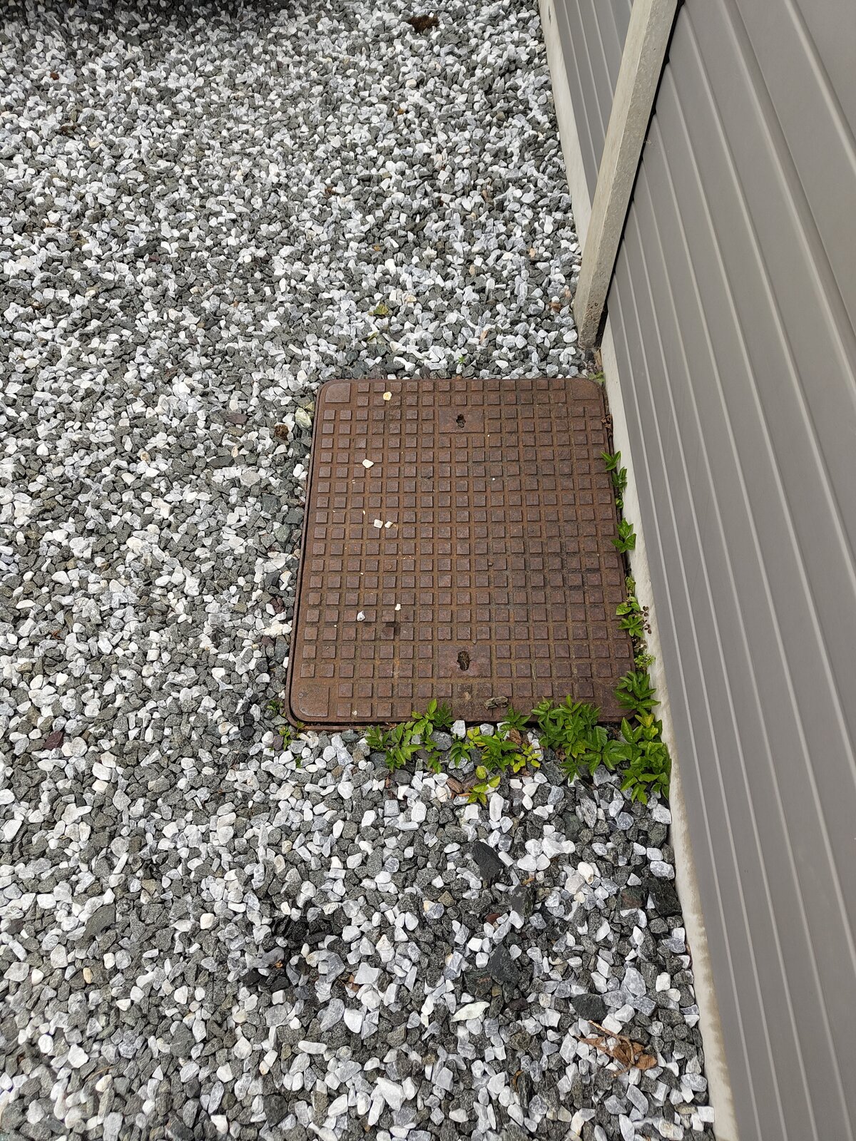

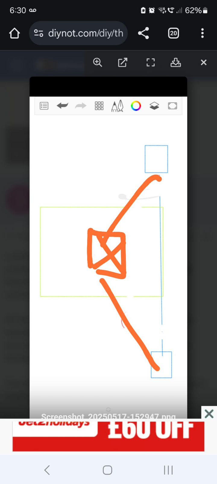

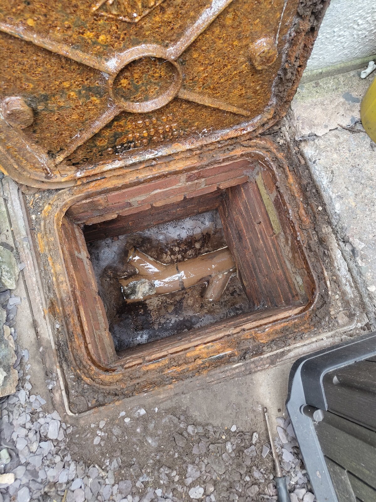

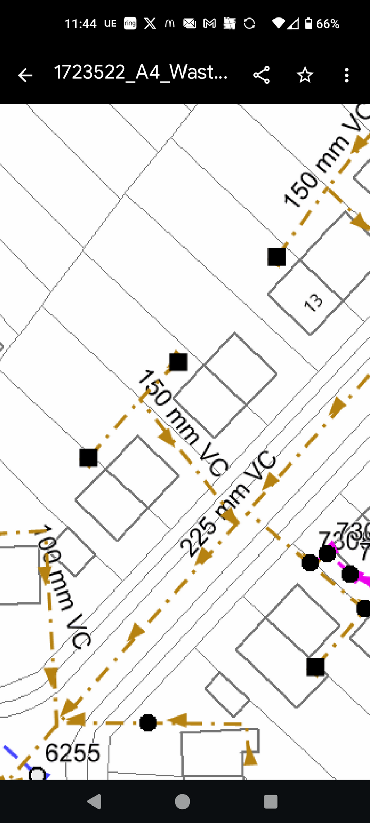

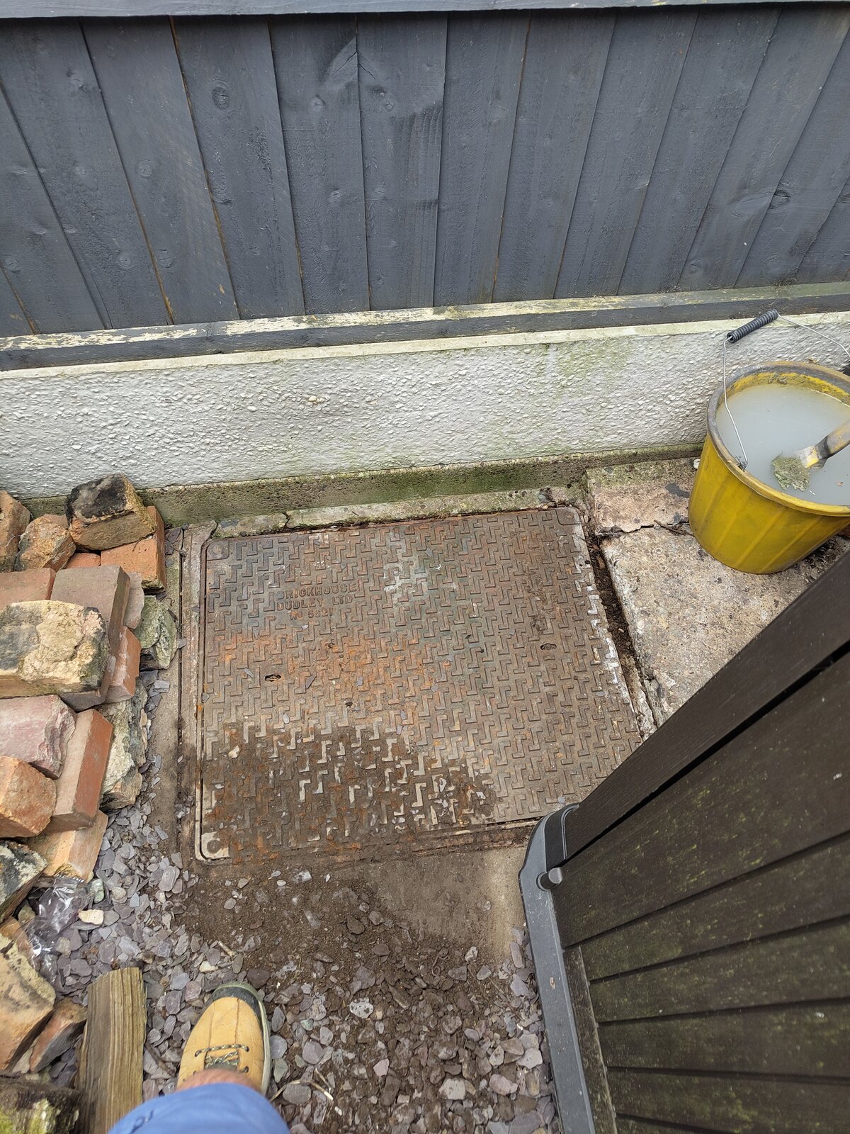

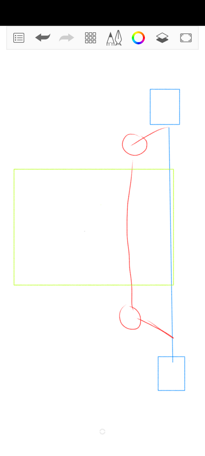

I’m planning a side extension to my property. The full length of the proposed footing will run in line with an existing 150mm vitrified clay (VC) underground soil pipe, which is approximately 1.5m deep and connects to a shared drain.
The ground floor of the extension will be a carport, so there will be no concrete slab—just gravel.
My question is: Can I leave the existing drains in place (as it will not be within the footings) and install two inspection chambers approximately 500mm to the side of the existing manholes. I plan to reroute the new soil pipe 500mm from the footings, and then reconnect it to the main drain.
I have attached some drawings (drain locations) and photos of the existing. I do love a challenge.
Thanks in advance.
Just added a new image with the existing manholes not shown on the Severn Trent plans
