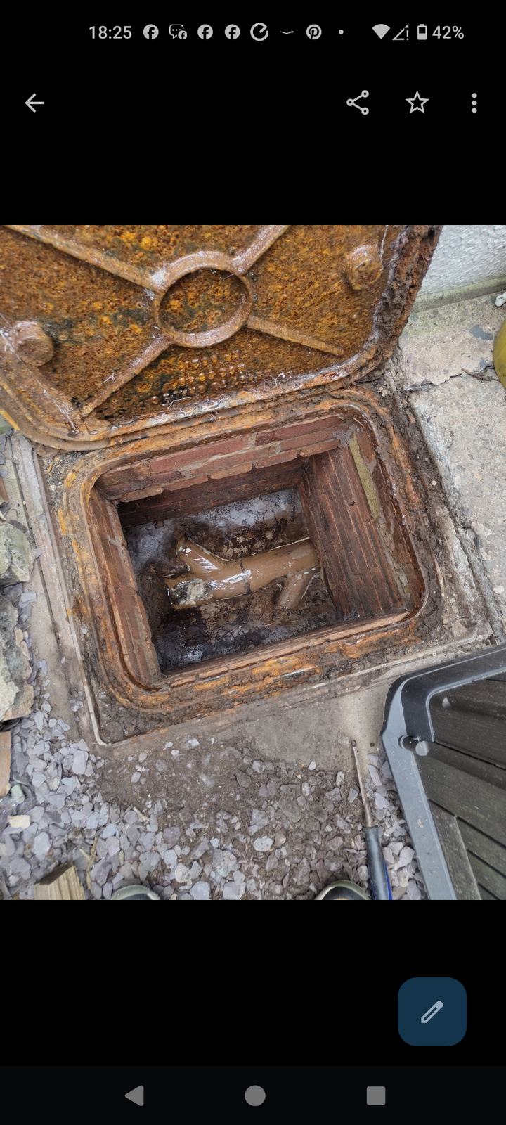

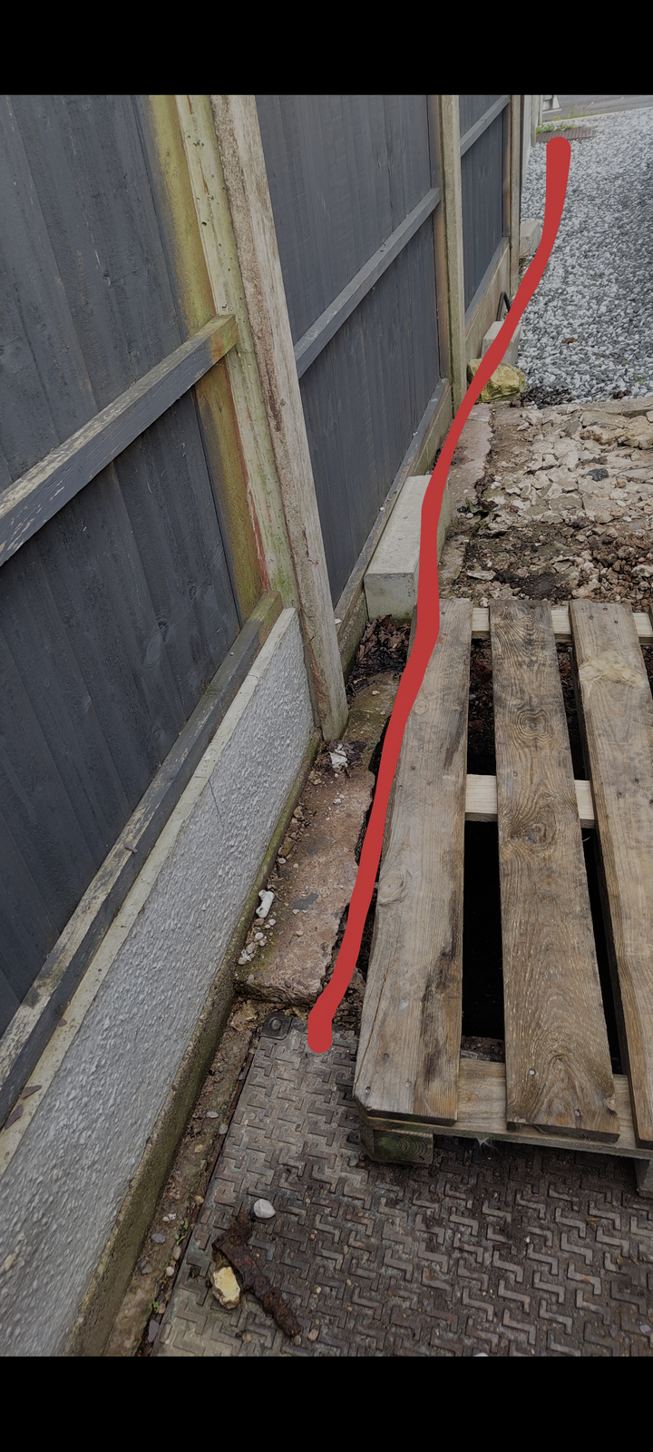

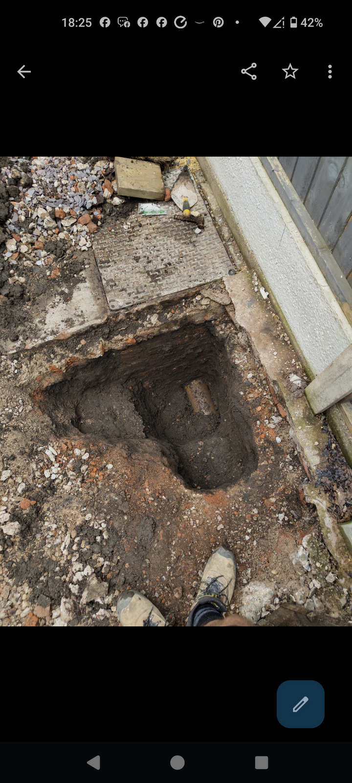

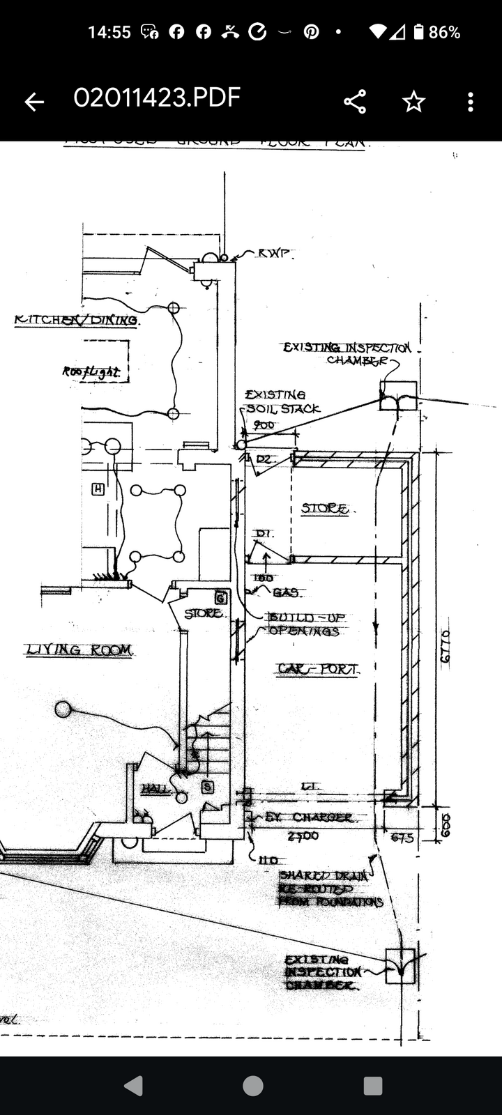

Here is the proposed drain plan. Unfortunately, the existing drain runs directly in line with the proposed footings at a depth of 1.5 metres—just my luck. My plan is to dig the footings slightly wider and construct heavy-duty shuttering to keep clear of the new soil pipe.Pea gravel around the pipe and backfill accordingly. Some people want silly money for this..I may take on myself. I'm hoping with the slow bends no additional drains are required.

I think the best engineering option would be to move the upper manhole left a couple of feet then run straight down to a new chamber on your existing front connection. ther last bit of which would then need upsizing.

The architect seems confident that his plans will work—just waiting on feedback from ST now. It’ll be interesting, as this kind of situation isn’t commonly covered online; usually, it's just a straightforward lintel pipe running through the footings and move on.

I have had AW approved contractors make suggestions that were laughed at by AW and BC.! Most architects are only good for pretty bits not the practical
ST will only be interested in protecting their asset, so don't be surprised if they ask for a lot more than you were expecting.
Often with a diversion for Building works they'll want it replaced like for like and may even insist on a chamber at either end.
