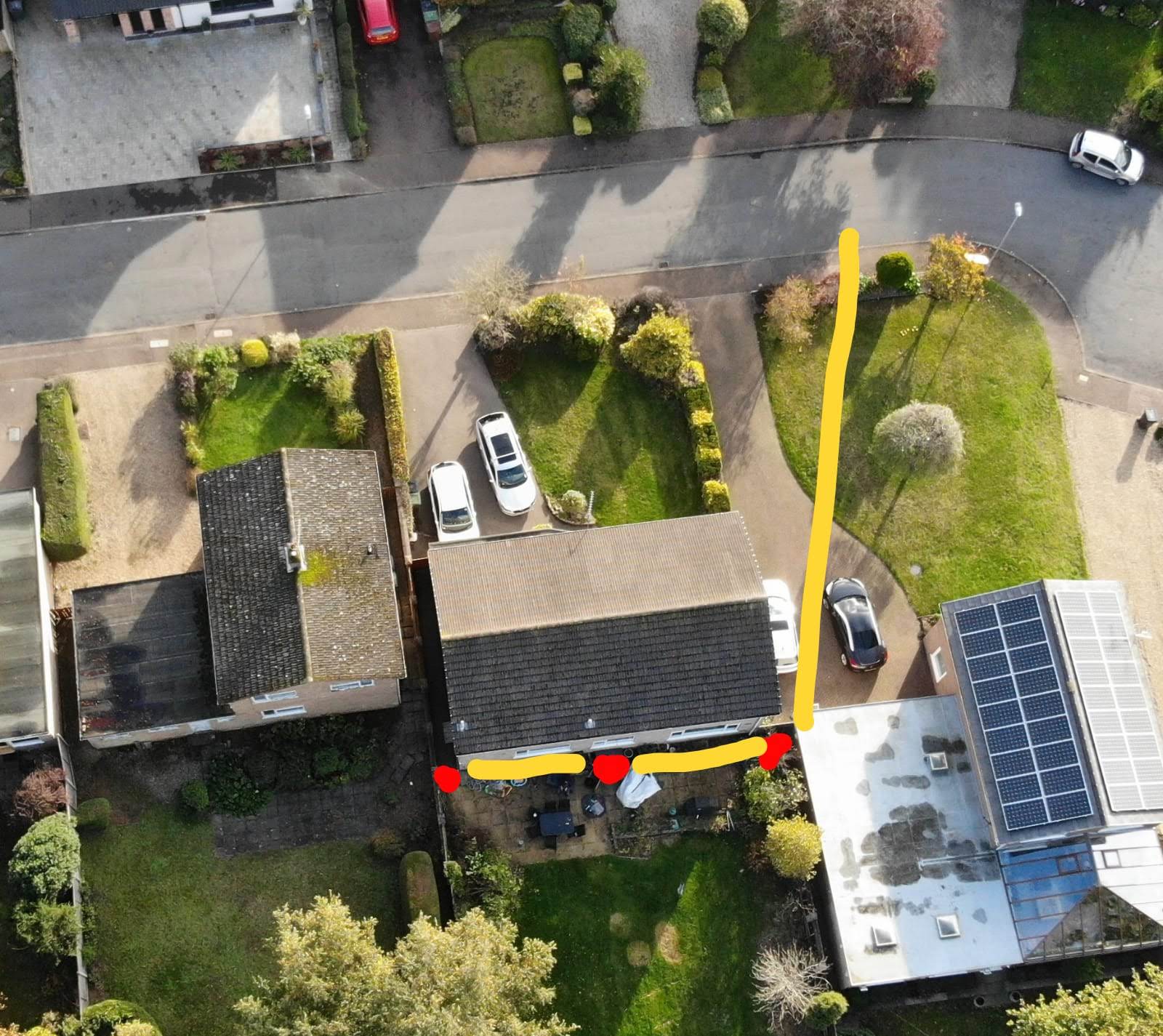

Hi all,
I have a clay underground drain pipe that runs parallel to the back of my property two soil stacks and the kitchen sink run into it and then it runs to the road. I have 3 manholes at the back - one at each end and one in the middle where the central soil stack is. In the central manhole there is a pipe leading into this which I can't identify, it comes from the direction of my house - pointing straight into the middle of the house. Its not anything to do with any of the soil stacks or previous soil stacks etc and there are no drains on the other side of the house or the road etc. It looks like a clay ribbed pipe. Could it be some kid of drainage pipe for under the house or somthing?
I am replacing all of this pipe with plastic and the extension is goin on top, the soil pipe going into this manhole is being moved to outside the extension so there will be acces for that but this I was just going to pipe up to a "T" and leave it.
House was built in the eairly 70s if that helps at all.

I will take a better picture later - this might help - this shows the house (middle one) - the red dots represent the inspection chambers. The one I am takeing a picture of is the middle one..
More pics... Sorry about the downpipe coming into the pic its temporary but didn't want to move for pic.

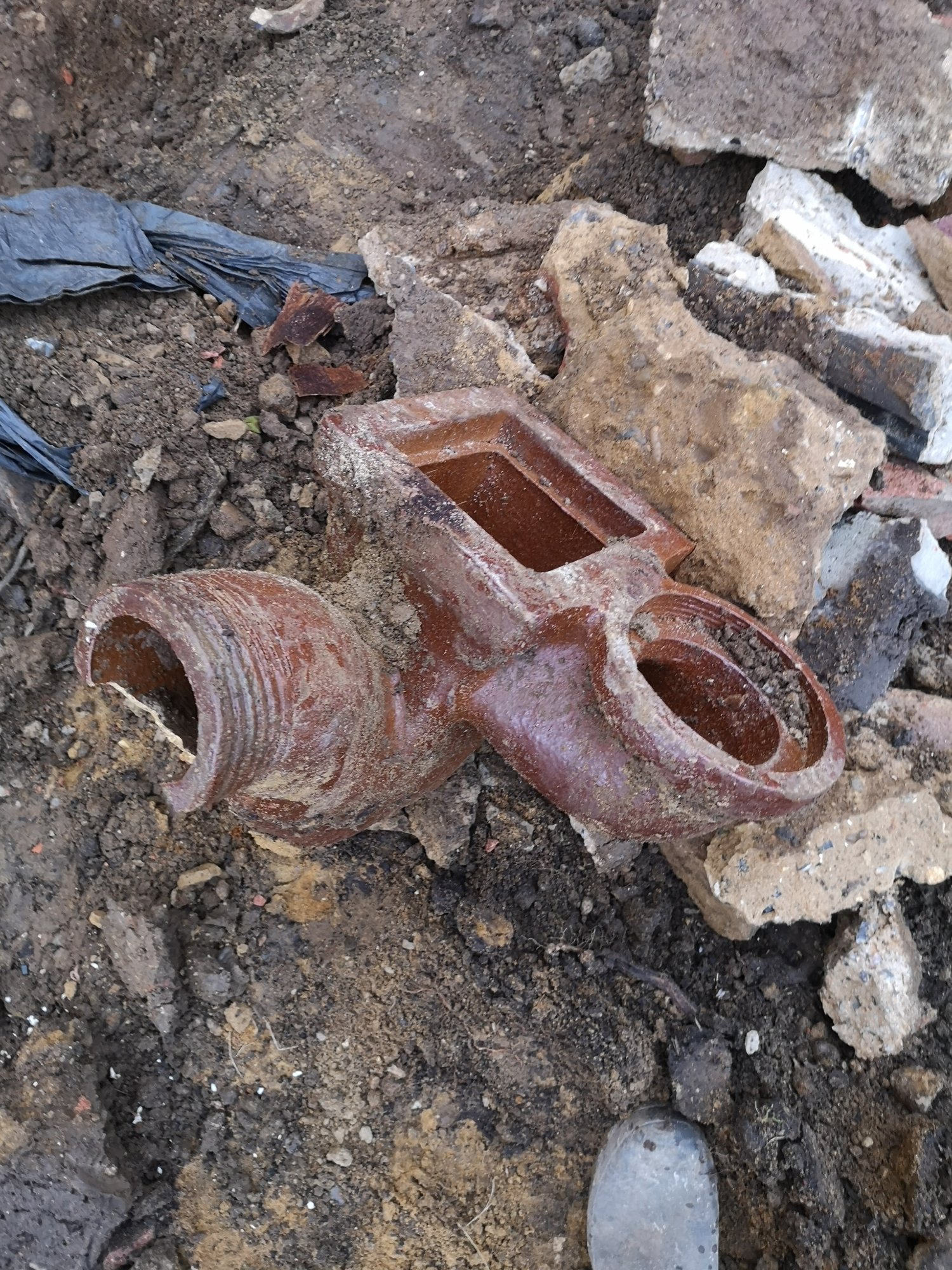

Have you only got 1/2 the manhole lid up on the middle pictures?
4 Jan 2014
224
3
Norfolk
All the manhole was up, but only half was accesable!
Yes Andy you were right! They obviously moved the drains at some point. Was certainly a releif for me. Relayed the main drain in plastic and waiting for inspection thismorning so I can backfill and carry on digging footings! Tha ks everyone.
