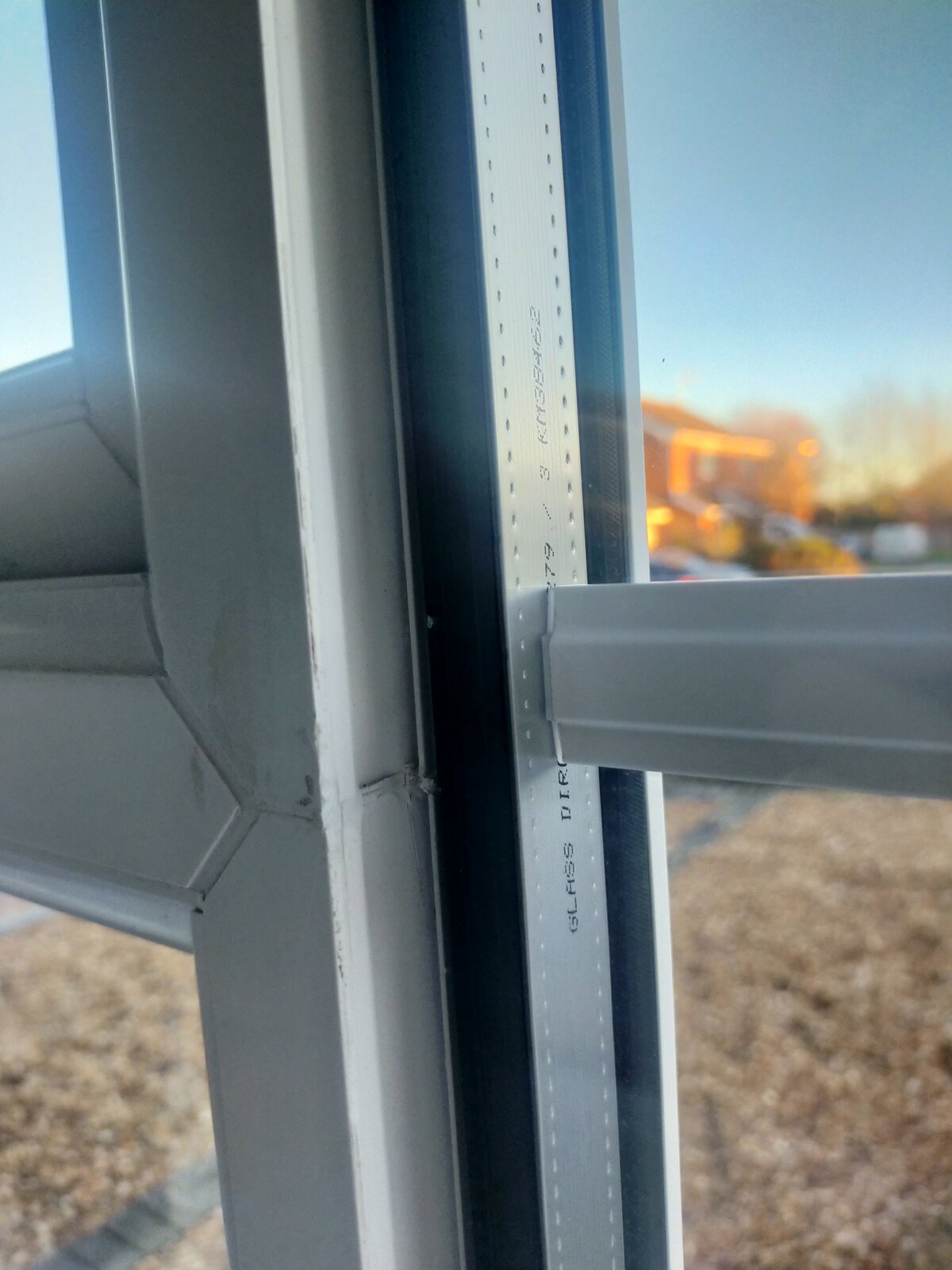

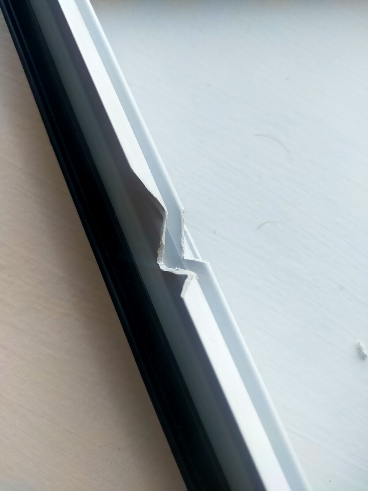

Can anyone help I've replaced a double glazed unit and I'm having trouble getting one bead to go in, it's a bit of because unlike the other beads it has a cutout in it no idea why but wondered if that is the problem.
Bill
The bead starts ok either from the top or the bottom but when I reach that bit that's cut out it won't clip into place, not sure why they've cut it either.
That's a duraflex bead, they can be a pain at the best of times, they cut the V because they can't clean the welds in the corresponding grooves on the frame
Appreciate you answering, The other 3 beads have gone in really easy tbh but not this one, any thoughts on a way to get it in please.
