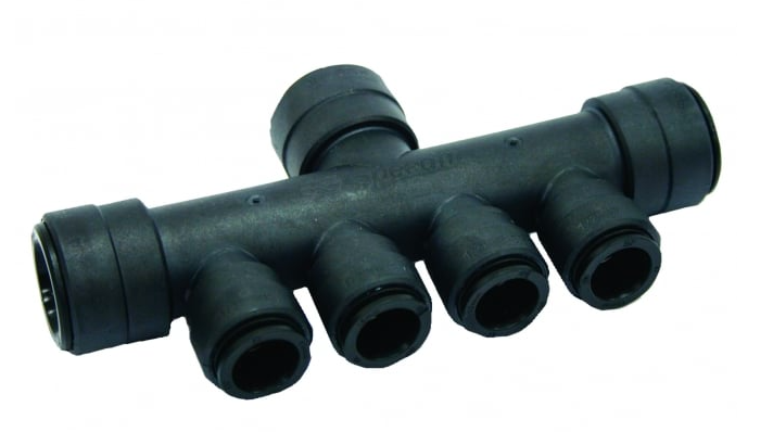

@ianmcd & @Gasguru , I hope you can help me a bit more resolving the issue with my "blocked" cold feed, actually I am now sure it is blocked, here is the story so far.
Basically I have 2 Speedfit manifolds (refer to the photo below) serving a total of 7 radiators:
The first manifold (manifold 1) serving hot water to all the radiators is very hot.
The second manifold (manifold 2) returning the water back from the radiators is not hot.
Therefore I cleaned the system by connecting manifold 1 to the main water supply and by connecting manifold 2 to a pipe which drained into the batch. I cleaned one radiator at a time by shutting off both TRVs and lockshields on all radiators expect one. There was a bit of sludge but nothing unusual, clear water now goes through each pipe. I also visually inspected the inside of the manifolds.
However I still have the same issue, i.e. manifold 2 not returning much hot water.
My questions:
1) The main water supply is quite powerful (fed through a 22mm coper pipe in manifold 1), when draining into the bath (through a 15mm speedfit pipe on manifold 2, could only use that) I noticed a pressure drop, but I guess this would be expected as going through a radiator. Would you agree? The flow out would have filled a cup of tea in 3 second, not sure if that gives you an idea...
2) After draining the system, each of the radiators refill quickly when bleeding. Based on this and point 1 above, I can only assume there is no blockage. Is this a fair assumption?
3) I am going to put some Sentinel X400, I was going to feed the product through the filling loop, based on my problem would you advise to put some in each of the radiators instead?
4) If all of that fails, do you think a power flush would actually help? It is quite expensive, hence would need to make sure.
Hope this makes sense!
PS: I would have thought that by only leaving one radiator turn on (connected to either of the 4 x 15mm tubes) I would get hot water back on manifold 2, but this is not the case. I find it hard to believe all pipes are blocked. Everything would point to an issue with manifold 2 but it is clear and water goes through it. Strange...
