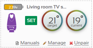

But my programmable TRV head shows on the PC target and current. Flat Battery TRV.jpgSo turning up the wall thermostat, so the boiler is not going to switch off, I watched the report, and if the current exceeds the target, I closed it a bit. And in parent's house with a modulating boiler, it worked A1, each room within 0.5°C of setting.
However, tried the same in this house, on/off oil boiler, and it failed. I think due to the boiler being designed not to re-fire within a set time. But also the use of micro bore pipes. I do not bother adjusting the lock shield valve, I leave them wide open.

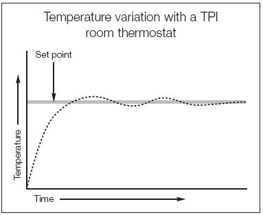

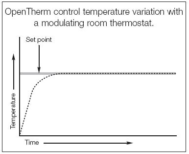

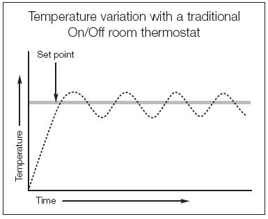

So my boiler uses a mark/space control, it fires up for ½ an hour, then sits there with just the pump circulating the water for an hour and a half, then fires up for another ½ an hour, this causes a hysteresis, Temp_variation_on_off.jpg where with the modulating boiler this is much reduced Temp_variation_TPI.jpg we are told OpenTherm can reduce it further Temp_variation_OpenTherm.jpg but only if the boiler has not been oversized. I had two boilers in the last house, fitted before the combi boiler came out, one for central heating and one for domestic hot water, the latter was 18 kW and other than filling a bath, it was ample. Very few homes need a boiler over 20 kW, and the heating of a large boiler to just wash one's hands, clearly does not make sense.
