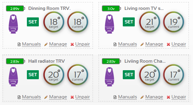

I can only talk about my own experience at my mothers old house. I was using electronic heads which reported current and target temperatures to the PC. I realised the temperatures were over shooting, set to 20ºC I was seeing the room heat to 22ºC, I realised what was happening was the radiator would get stinking hot, and so was still heating the room even when the TRV had closed, when the TRV's exercise at 12 midday every Saturday it takes around 3.5 minutes to do whole cycle, and it takes time for heat to reach the TRV to start with.
So the report 4 TRVs-1.jpgmakes it easy, if any radiator in winter has the current above target I closed the lock shield a little, after some time I had got it so every room except for living room was spot on, living room was a problem as it had bay windows, so morning sun could cause the room temperature to raise above setting even when central heating not running, nothing I could really do about that, except did not adjust on sunny days.
The thing I noted after it was adjusted is the boiler would modulate better, (Worcester Bosch rather old) and the radiators were not longer stinking hot, but just warm enough to maintain the room temperature. And there seemed very little hysteresis in the room temperatures.
