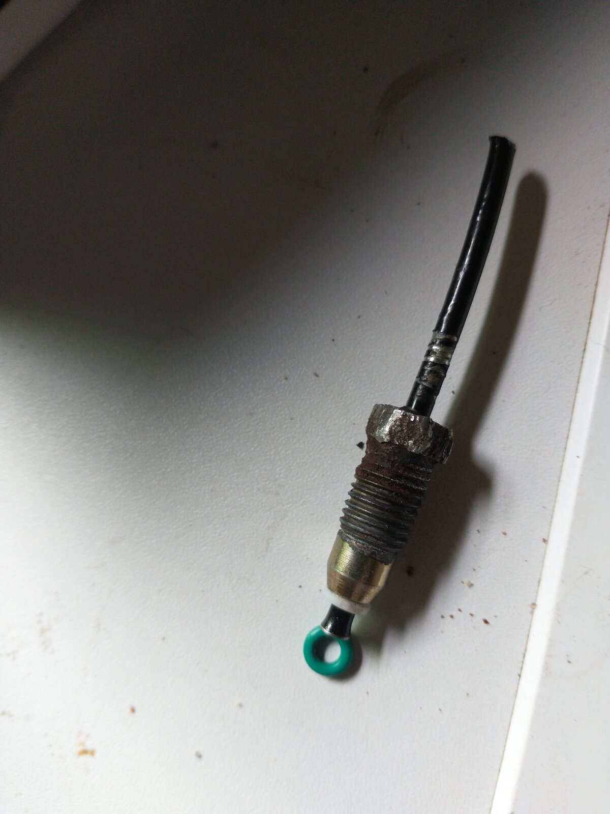

Here's the original coupling, not 100% sure whether the green o ring goes between flare and alloy or between white ring and flare.

Ah, this wasn't what I expected to see but it does take me back to the BX models we had.
I would have thought the green ring goes before the white ring, but don't know for certain. Peter N. was the guru on these, sadly he doesn't post too often now.

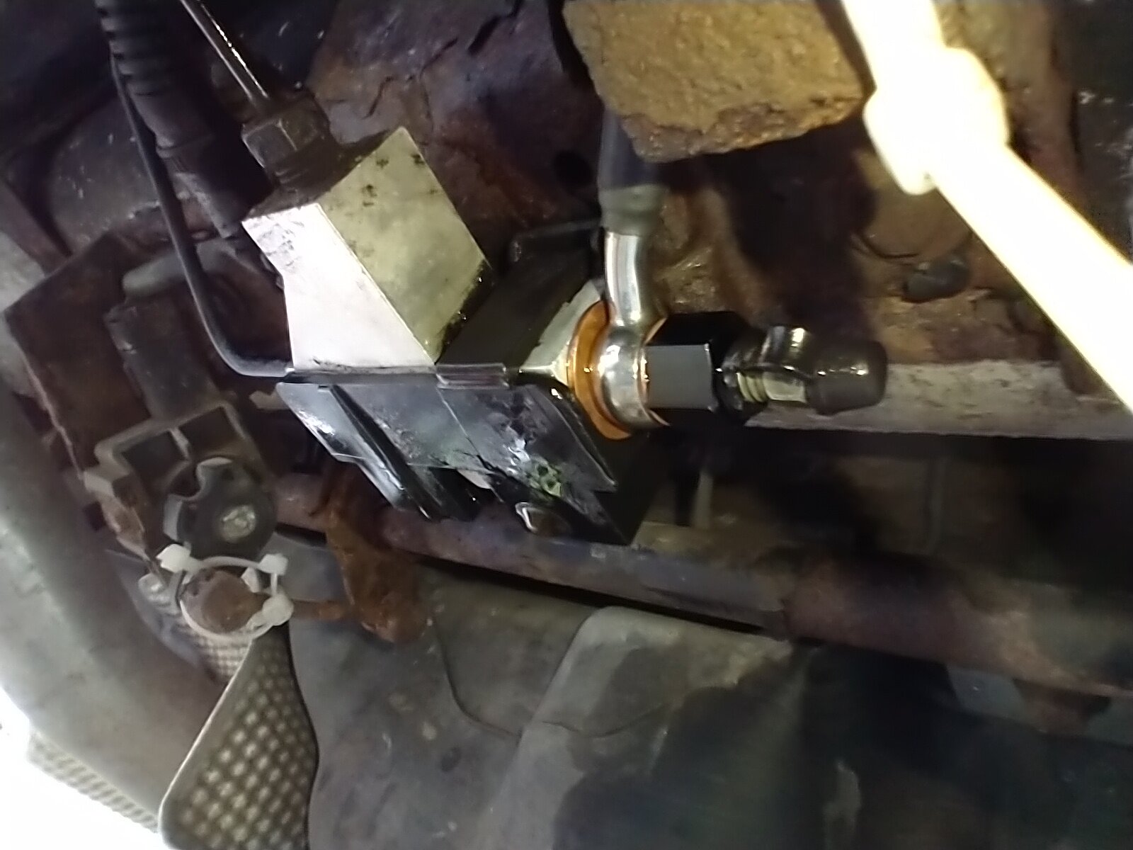

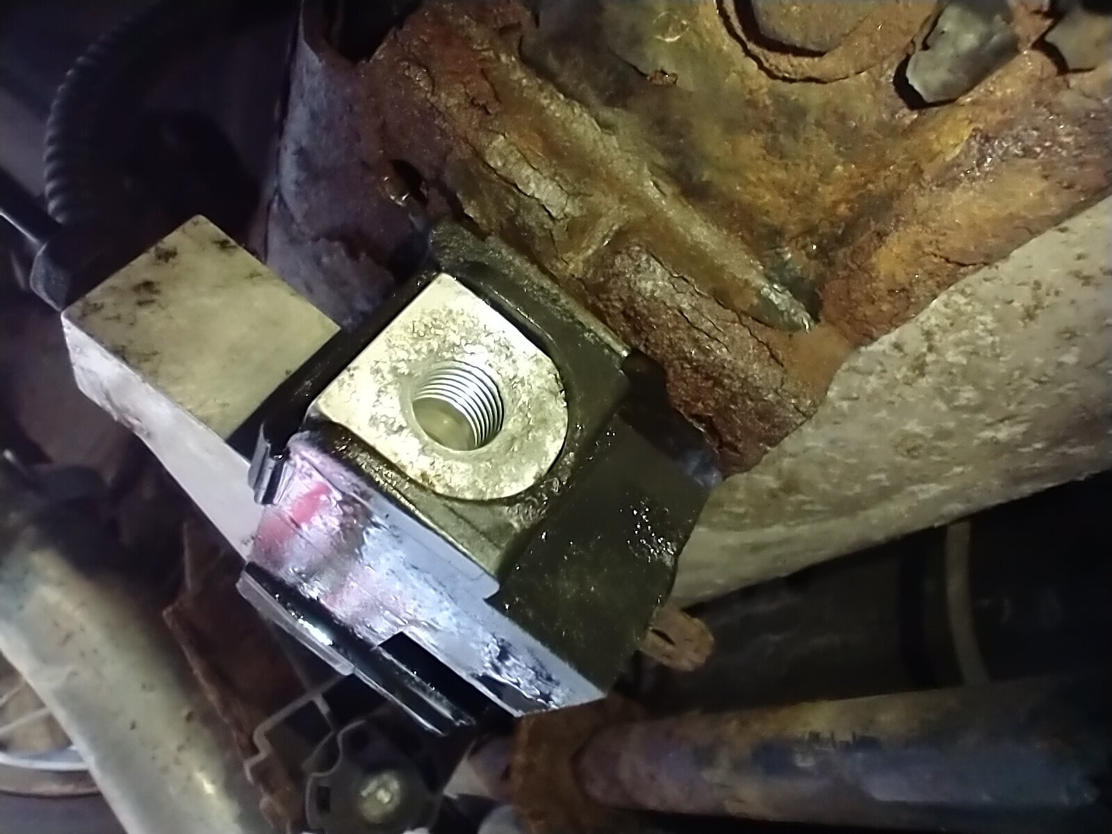

Right. Here's the end that failed (spectacularly - a gusher of fluid which i didn't video cos at £10/litre this game is getting pricey.IMG_20230813_191827273.jpg
The gusher was coming from the large copper washer- posh T piece interface. Or possibly from under that plastic cover but i don't believe so, there was no sign of leakage at that end before i started playing.

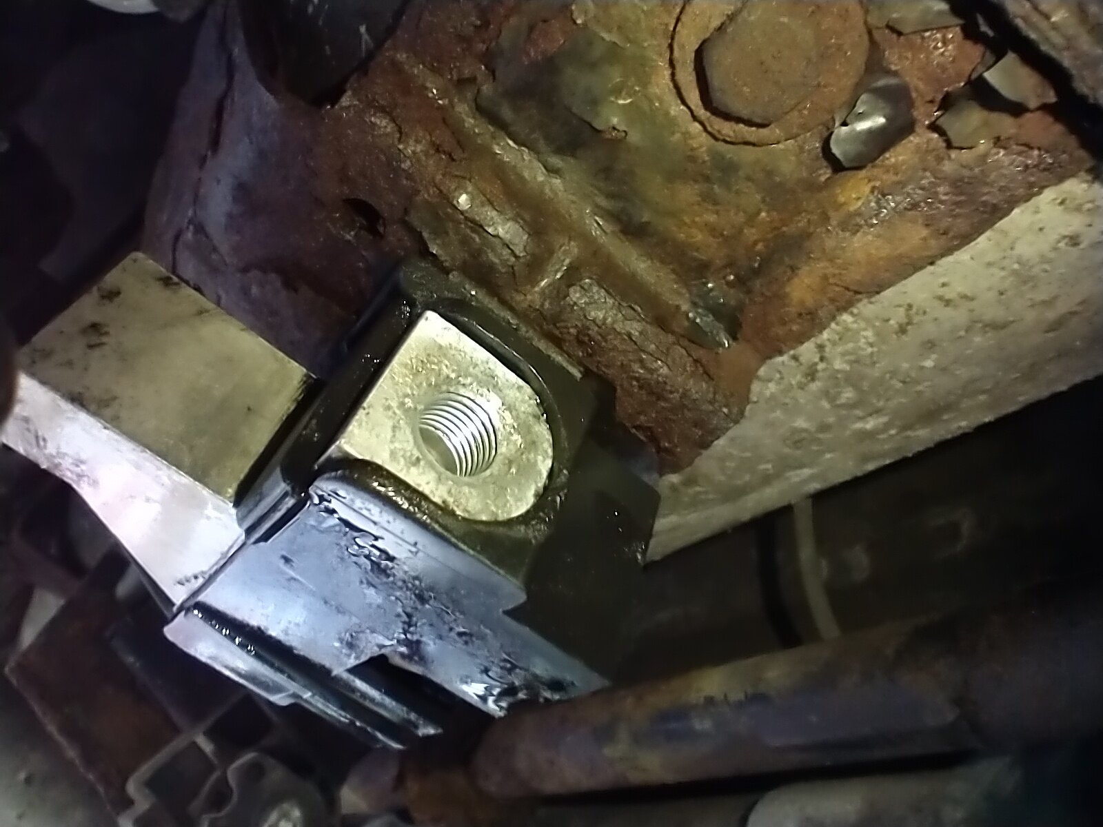

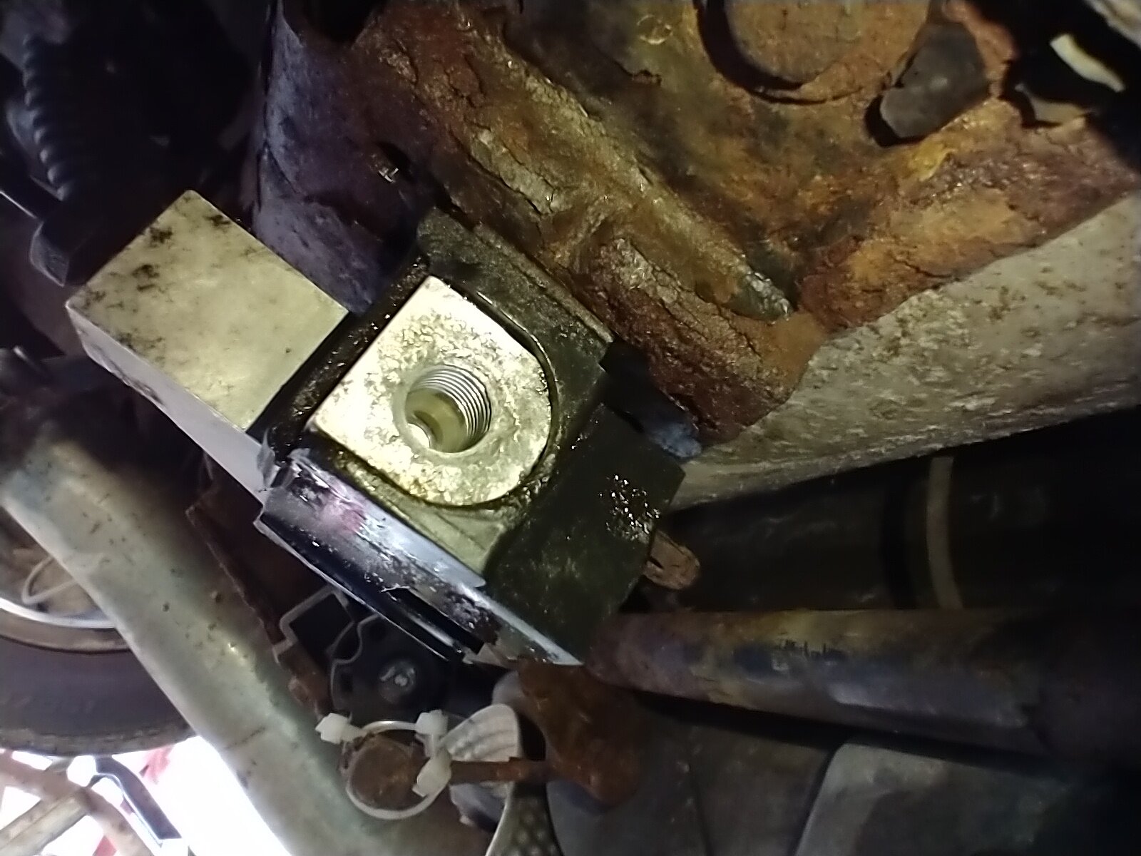

Here's the mating face- looks pretty rubbish to me.
And another
And another

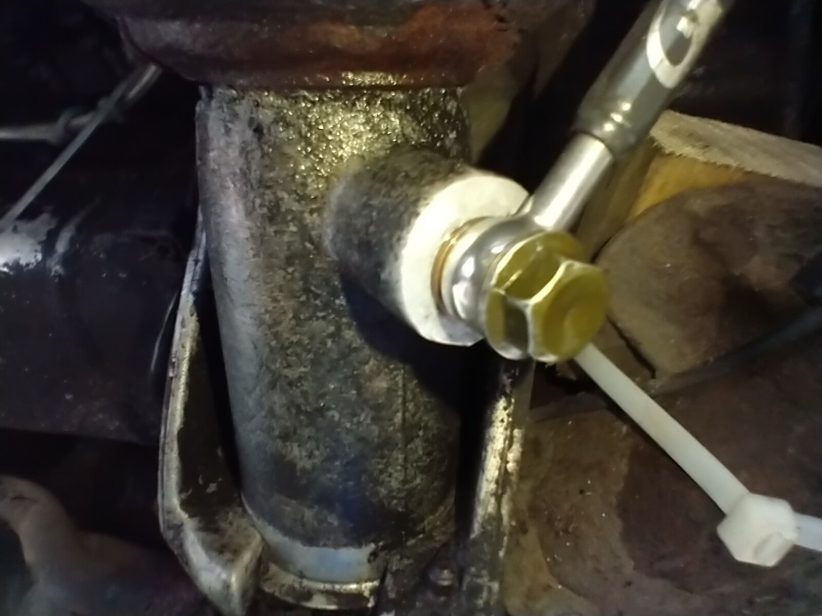

Here's the other end - this was slightly wet rather than erupting.

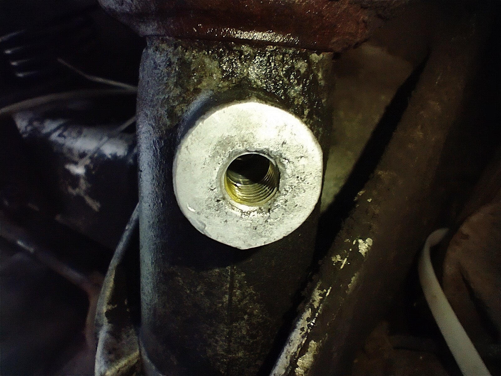

And here's its face- in better nick (of course, its much easier to get to than the t piece face)
So.
Do these look like suitable candidates for Heldtite or similar (assuming i get no luck on my continued quest for a proper replacement)
TIA

I would be inclined to give the faces a rub with some worn emery wrapped around a flat file. Just more of a polish rather than taking lots of material off to achieve a flat face. A dowty seal may be better than a copper washer. Although a crush washer may also help create a seal. I cant remember if that’s its correct name, a circular hollow copper washer that crushes down as you tighten the banjo bolt. If you use a flat copper washer make sure its annealed first.
I don't think oversize washers would be successful unless they are absolutely perfectly flat and square to the mating faces.
I am a big fan of heldtite and used it successfully over many years. If you use any of the methods above I would make sure to leave it overnight to set/dry before introducing any pressure.
You could also try one of these new products they use to seal mating faces of gearboxes etc nowadays.
You could also try belzona, its a two part mix that can be used to fill pitts. It needs to be scrupulously clean and oil and grease free. You could then flatten the faces with a smooth file.
A small engineering works may be able to weld those pitts to build up the surface before re machining the faces.

That large copper washer is distorting.....with banjo connections, the washers need to be the same diameter as the banjo itself.
Try alloy washers, which can be annealed of course!
VAG cars suffered badly from this where the flexy brake pipes mated to the caliper many years ago - thick alloy washers sorted it.

I should have also said, any washers must be tight on the banjo bolt, with negligible clearance so when they are tightened they swage onto the bolt itself.
John
Cheers both. If the banjo bolt was long enough i'd have put a steel washer behind the large copper (to prevent the deformation), it did occur to me that that large washer might dish rather than seal to the less pitted outer circumference.
The connection on the suspension strut (that was weeping) is of course much easier to get at- very easy to knock that one down a bit with wet and dry.
The connection on the posh T piece is a bit nastier to access cos of the plastic carrier. Which I'm not going to try to remove cos there are 2 other steel lines going into it, good odds i'd knacker one or the other.

Spoke to a nice chap at a company called Pleiades (who specialise in this sort of stuff)- they can't replicate the flare. He did mention that the T piece (where the monster leak is) is only a casting (not machined) so facing that off is this afternoon's project - ideally when the rain stops!
Of course the ideal would be take it off and drop it to my mate to get it properly faced- but that would mean disconnecting 2 more unions.....
