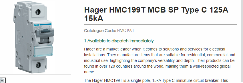

I have seen single pole (online) MCB’s is rated at 125A, they may go higher?
Not sure you have, i believe 63a is the highest rated mcb's you can get. There are mccb's in larger ratings but they will not fit in a standard 3 phase board.
I can't say I've ever previously had need to look, but here's a couple for starters .....
Kind Regards, John
Those Eaton and Hager MCBs are ~1.5x the width of a normal MCB so they can't be used in normal outgoing ways of regular boards. The EATON one's description says it's for use in special boards, the hager one doesn't seem to say how it's intended to be used.
I remember TLC used to sell including 100a MCBs and special cable assemblies that could be bolted to the busbars so you could fit the higher-rated MCBs in an extension box to one of the brands of board they carried (think it was contactum) but they don't seem to sell them anymore.
Fair enough. As I said I was just 'noting their existence' (since I've never had reason to look for them before), so I didn't bother looking into details.
Yes, I noticed that it mentioned "high load boards". I suppose I assumed that just meant a board with something meatier than a 100A incomer, not that the width rendered it unusable for 'regular' busbars etc.
Kind Regards, John
70 amp with the Loadmaster board which was larger than normal miniature contact breakers, but once you go to non miniature then 300 amp moulded breakers are common, and to be frank when using the heavier cables required one really needs a larger breaker with larger terminals.
