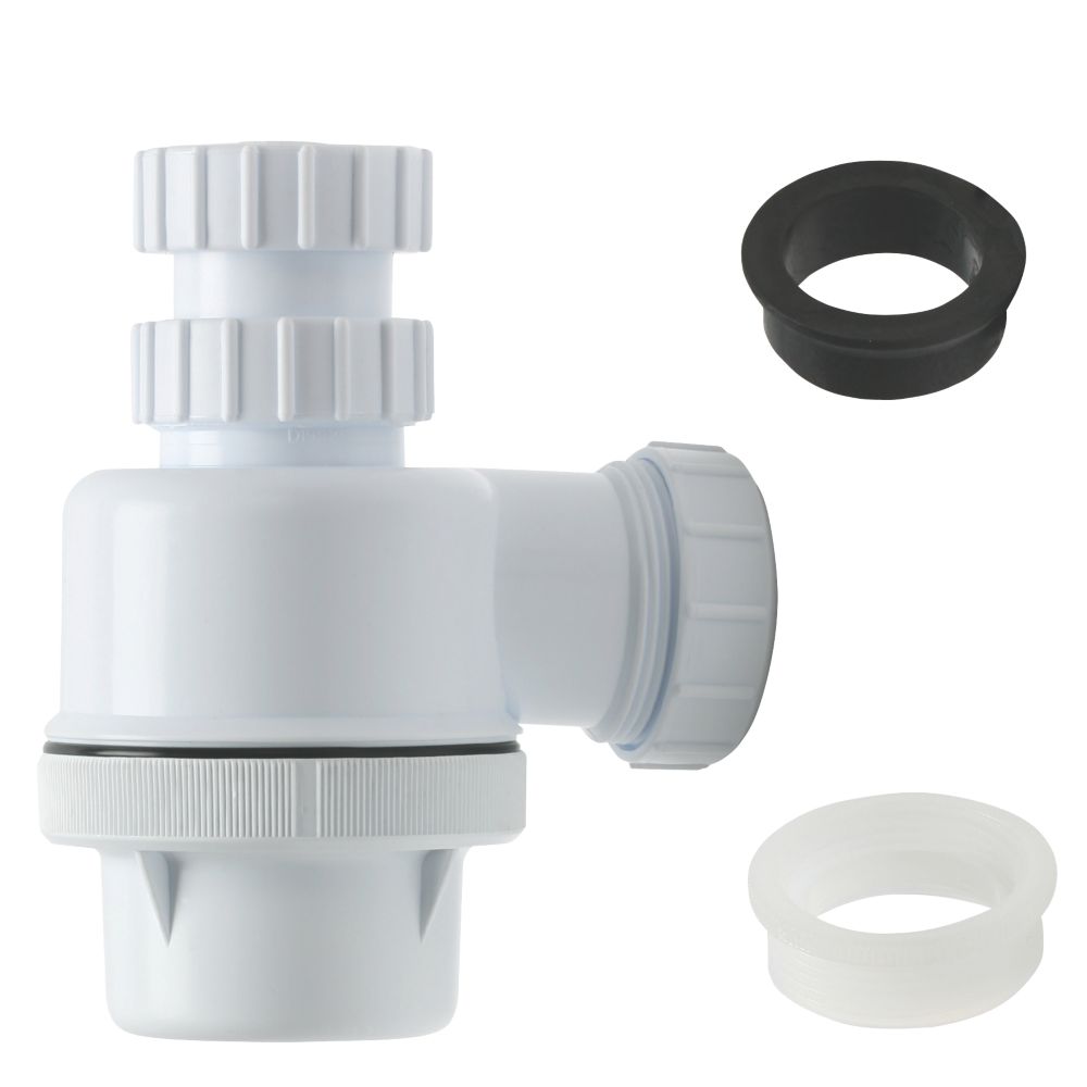

I'm trying to replace the waste in my downstairs WC. The existing waste is 11/2 inches as is the pipework below. I'm struggling to find a 1 1/2 inch basin trap though. I'm guessing I can't substitute a 1 1/4 inch version as the gaps will be too large between the basin and the traps? Any ideas please? The basin, etc. was bought from bathstore before we owned the house. Many thanks!
1 1/4" is no good for a 1 1/2" trap as the builders of our college found out when we moved in.
They fitted the smaller size to all the outlets, (over 75 outlets), and tried to seal them with excess silicone. They should have tested them afterwards because we discovered as soon as we started using them we had leaks everywhere. They had to come back at their expense and replace every single one of them plus pay for the damage the water had caused to the cupboards the sinks are fitted over.
Screwfix sell them.

Pity you didn’t study Plumbing conny,,!
There are adapters to do practically everything.

Properly designed plumbing waste systems should always be one size larger than the source outlet. It minimises siphonage of the traps! A proper plumber knows this and uses an internal reducer for such applications.
