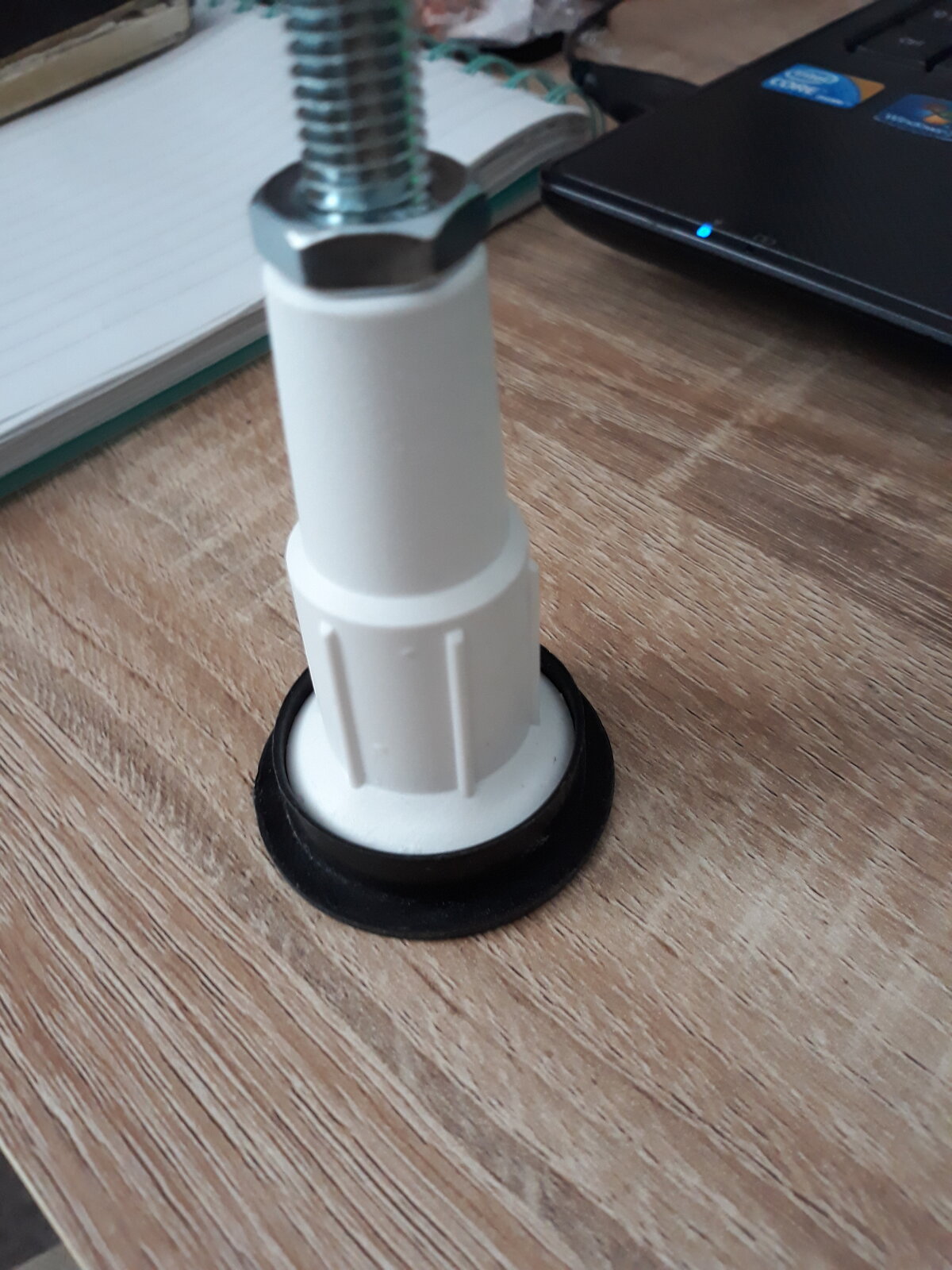

As above, the feet that have come with my bath have no holes so can't screw them to the floor.
Shall I bin them and get some others or is it not necessary to screw them down?

Presumably the feet will be hidden by a panel?
Get a small bit of thick ply or hardwood.
Drill a suitable hole all the way through, thread the leg through, recheck levels, secure the wood
Or
After drilling the wood, cut it in half and secure to the floor - surrounding the leg

Great idea, thanks.

why? where will the feet go if he does nothing.
