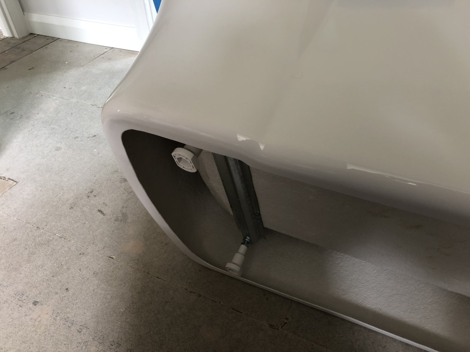

Hello all
My parents have chosen a sort of freestanding bath for their en-suite install but I can’t work out how to actually fix it to the floor. I have attached a picture of it and the feet have screw holes in them to screw them down. However the sides are fixed so how the hell are you meant to get to these screw holes? I’ve sat on the edge and it would tip up easily so needs to be fixed some how. I would not like to use expanding foam of anything in case of leaks.
It’s an adamsez essence bath if it helps.
Thanks!

Silicone round the skirt. It won't move... Massive contact area between bath skirt and floor, plus... If you glue the feet down you'll never get to the trap for cleaning/replacement!
