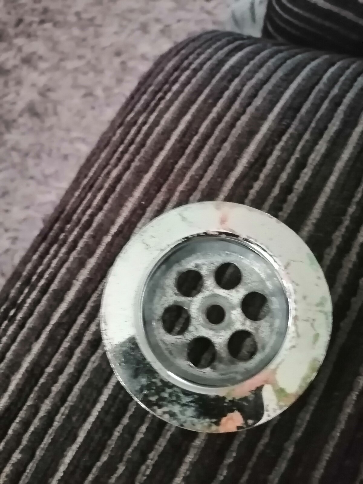

Hi.... can anyone tell me where I can buy a bath waste top like this. The top flange is one and three quarter inches and the push in part is one and a half inches there isn't any thread it just pushes into the top of the waste pipe.

sorry for the delay.....unfortunately the bath is tiled all around. I cant get to to waste trap or the overflow. That must be why the plumber put a push in waste top.I was thinking of buying a threaded waste top and cutting the threads offf and just leaving a lip to push into the waste drain hole.
The hole in the centre of the top plate is to accept a machine screw which secures it to the waste trap below the bath. If you buy a new kit then just use the top plate and the screw to refit it but be careful not to press down onto the waste below the bath as it will only be stuck on with sealant so go carefully with the screw and don't overtighten it either.
Thank you for that I was just wondering if I could just buy the top plate, but will buy the whole over flow if not.
