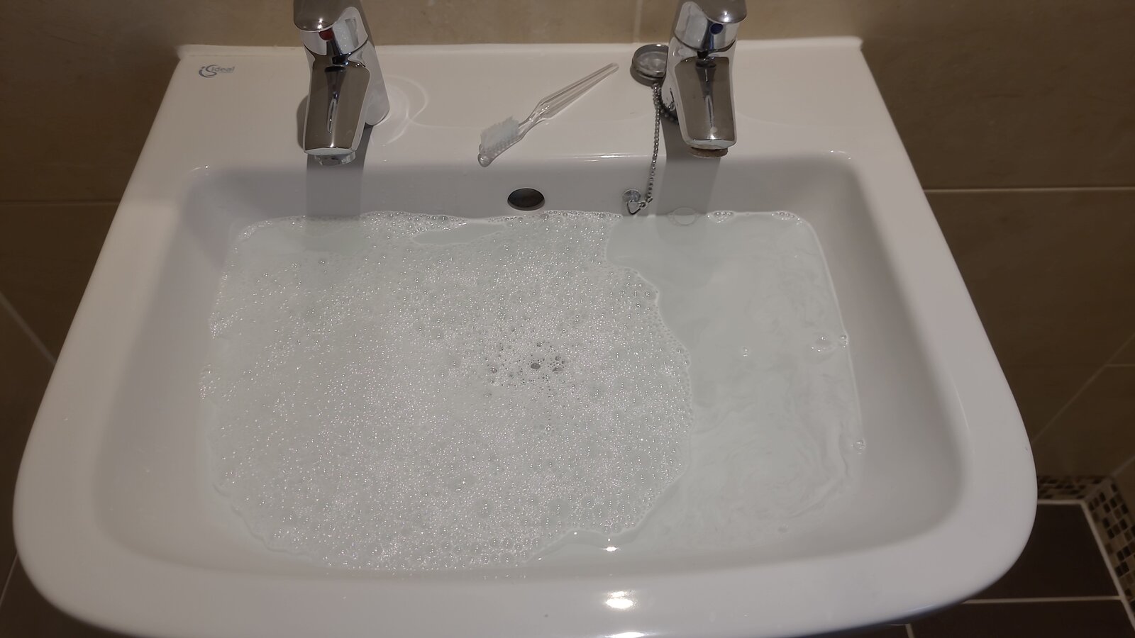

Hi,
See pic attached of the basin in the house I just purchased.
The previous owner confirmed he only had slow drain but no blockage like this and was advised by his plumber to just use some Mr Muscle fron time to time.
I applied a bottle of Mr Muscle and still the basin takes more than 1 day to drain.
Any suggestion on how to go about investigating what the problem is?

Take the trap off and see if it's clear ,not partially blocked.
If that's ok refit it ,run some water into basin,and use a plunger on the basin plug hole and cover the overflow whilst plunging.
As above, likely blocked, especially if there were any kids in property/visiting - had it loads and usually full of cotton ear buds.

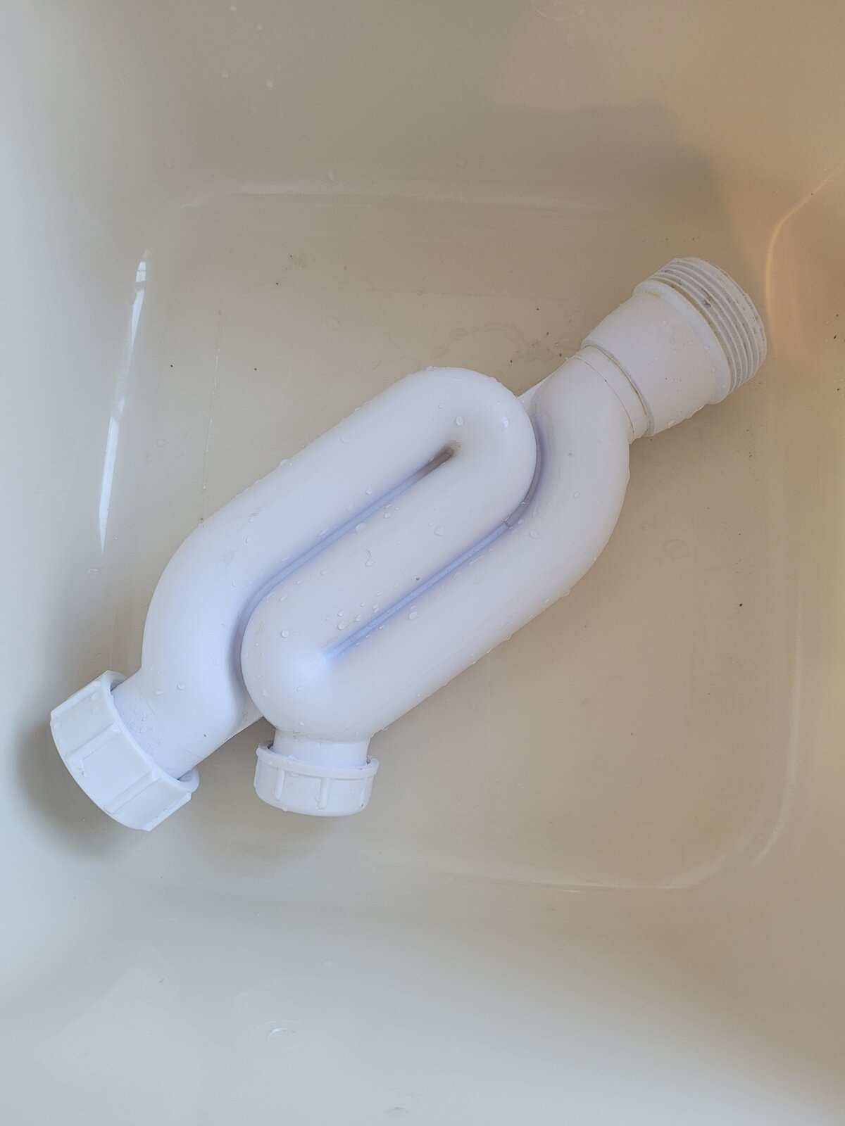

Removed the trap - some limescale but a shape that is designed to kind of accumulate water (see pic). After removing the trap i can see through the basin plug hole, so the order from the top is basin plug hole, trap as per pic and then short straight pipe into the floor...
I'll try and pour water in the bottom pipe to see if it does not drain. If water on this way does drain, should I change the trap to be a straight one of the same length? Not sure I follow the design of a trap in S shape...

Does water flow through the trap freely? Most blockages occur in the trap, because things that cause blockages cant pass around those bends.
Replaced trap with brand new trap and issue still occurs - I'll try the plunger suggestion next.

I wouldn't put a huge amount of faith in the previous owner's explanation.
You know now it's not the trap, by all means try the plunger, after that you need to trace the waste pipe to outside/soil stack. Good odds there's either a flat or uphill section or a hard bend full of rubbish.
