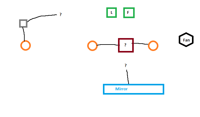

The old lamp that was in there was a standard GU10 lamp holder - not IP rated, no fire hood and no earth.. The glass on the bulb has actually cracked. Likely due to the heat from the old halogen and the steam...
My expectation here is that the original bathroom has 1 light.
The previous owners then cut the T&E off, detaching the original light, and then realised the T&E didn't reach the bathroom. So they installed a JB and ran 3 cables from the JB to each light, rather than just going to one light and feeding off the block connector in each
Note: I didn't fit these, they were fitted when they had the bathroom redone by previous owners - expecting this was a DIY job..
If you are going to get the Aurora M pro's, looking at some of the spec sheets they are double insulated class 2 and state they do not require an earth and are IP65, air leakage, fire rated etc... So if there is zero possibility to run a new cable without destruction then fitting these should certainly be a safety improvement over what you have already. Failing that, what I mentioned before about a transformer on the flex and then a 12v light above the shower.
Ah good spot, I completely missed that on the spec sheet. I have the M Pro for above the shower which is where there is only a 2 core flex.
Regardless of this though, it'd still like to see how they actually wired the lighting in the bathroom up as sticking a GU10 lamp holder above the shower cubicle without an earth doesn't really instil a lot of confidence...
Well - we still don't know if the lights are Class II or not....
There are no markings on it, but since this is quite literally a GU10 connector into a 2 core, I'd say they're not but I could well be wrong
I'll get a photo in a second.
This one isn't above the shower and its one I replaced with an LED a while back as the halogen failed. The one above the shower is identical but with an old halogen instead

Anyway, I've routed around and managed find the following:
full
  • All lights apart from the shower cubicle one (left) have Class 2 markings on them
  • The left light comes out of a JB and there is a T&E going somewhere. Looks to be in the direction of the light switch
  • The other 2 lights seem to go together at some point, but I cant figure out to what
  • There is also a bathroom mirror with leds in it that is being powered by something. It runs independently of the lights though, but the cable goes towards the unknown red box
  • There is a fan which comes on with the lights but I can't see how this is wired in.
