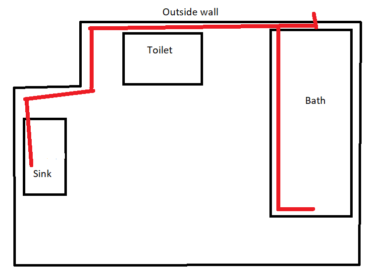

I've been undertaking updating my bathroom over the past few weeks, it's been slow progress as I've been doing most of it myself and has certainly been a learning curve!
After filling up the bath to seal around the edge, I pulled the plug today to drain it but the water didn't go anywhere. I could hear it gurgling up the sink u bend but not down to the actual drain. I then realised a couple of hours later that the bath waste was leaking which dripped through to my downstairs neighbour causing his electricity to short but that's another story!
After using the sink today, I realised it was coming back up the bath waste pipe and leaking out.
I don't really know how to go about investing it and am confused about what has happened. It wasn't blocked at all before I took out and replaced everything and the water isn't draining at all, it's not like it's just draining slowly. Any advice welcome!

Follow the pipework you've done trace it, the sink pipework and the bath pipework can be teed in together in to one other pipe .....where does it go.
I think you've made a fundamental error !
Anything dropped in and lodged itself in the pipe?
I didn't actually do anything to the pipework itself, just took out the old fixture and fitted new ones in the same place. The bath was disconnected for a while as the room was being plastered and I was decorating but I made sure to unscrew the first bend in the waste and clear out any debris that could have fallen in there. I didn't use any rags or anything like that. Also, I don't understand how the water is flowing form the bath to the sink and vice versa and not down the drain. I've attached a very basic diagram of the layout with the waste pipe in red.

Based on your diagram , the join between the Sink and the bath by the wall - from that joint out the wall and down to the drain, maybe blocked , perhaps Plaster has gone down that pipework and blocked ?
If there's a blockage in the pipe or no connection to the pjpe that goes through the wall to outside then waters got know where to go but flow between bath and sink. I would check under your bath first to see if you are still connected to pipe going through wall then check pipework for a blockage.
I'm definitely still connected so there must be a blockage after the pipes meet. I'm just so confused about how it happened but never mind! How do I go about sorting that? Do I need to get one of those claws? (Please excuse my ignorance!)

Fall isn’t enough or falling the wrong way
if the pipes are clear and falling the right way, put a non-return on the bath waste pipe
