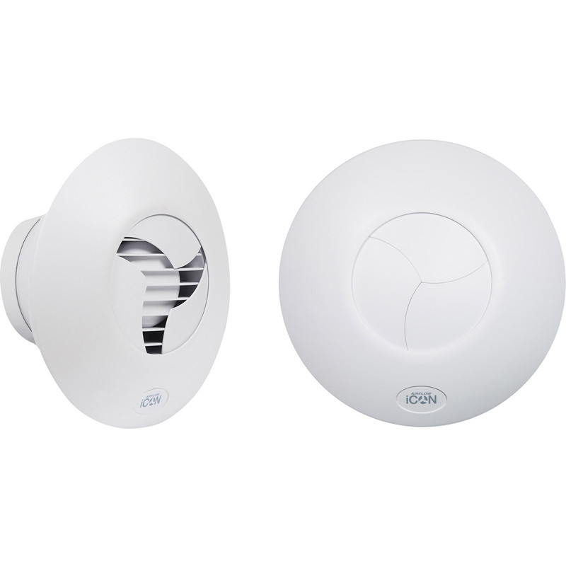

Is it Continuous Running and could you explain the "noisy until it's open" Brian?

The noise is part rattle from the flaps when it is partially open, and the air noise is louder, presumably because a lot of air is moving through a small hole
Do you mean you have the rattly flaps type of vent? Like a badly made venetian blind?

No, the Icons have wax motor powered flaps on the front...
