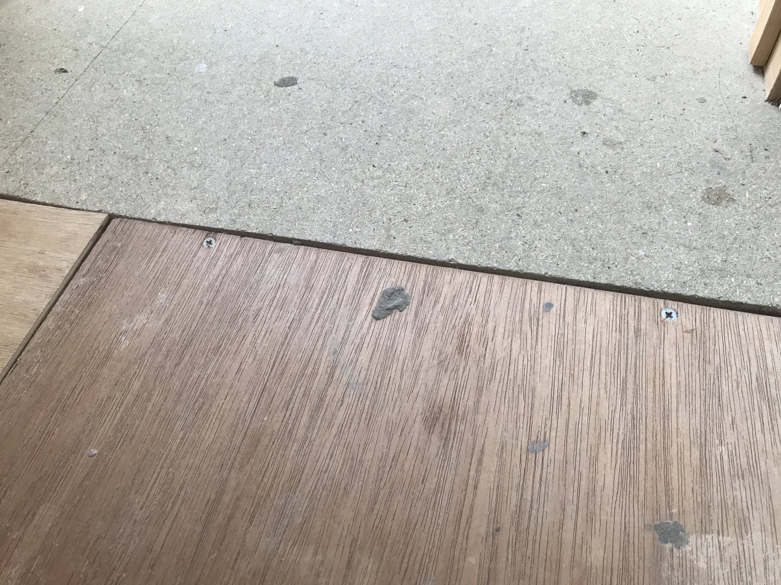

Whats the best method to level this so we can fit lino in the bathroom?
You can either use 4x2 hardboard (if the difference isn't that great, or 6mm plywood. You'd use ring shank nails on the hardboard, and 20mm screws on plywood, set every 6" round the edges, and every 8" in the middle.
