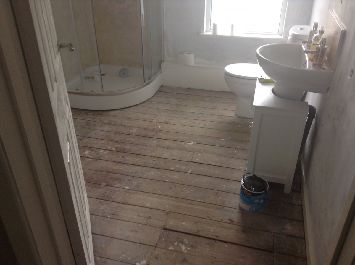

Cheers. The room is 9ft by 7ft 8 I've been getting quotes ranging from £100-£200 I wouldn't even know how much I'd need to buy
Standard sheet is 8 foot by 4 so just over 2 sheets. If you go to wickes or b&q they'd cut it for you to get it in your car.

Thanks the room is 9ft by 7ft 8 how many 8x4 sheets would I need do you reckon? Thanks.
Are yu going to take the toilet and wash basin out; you'll get a much better job if you do.
In theory, you only need 2 sheets, but it'll make for a bit of a patchwork job, and you're going to end up cutting the sheets into smaller sections to get them to fit, if you don't take the bits out first. Looking at the room, I'd still go for 4x2 hardboard.
Went to b and q today and they do 3.5mm hardboard 8x4 they can cut them down. I'm moving the toilet basin and sink yes. Just wondering what I would use to attach them to the floorboards?
20mm ringshank nails. They have serations around them tat stop them creeping out. Tacks etc will come lose over time. Nail them every 6 to 8 inches in a sqaure grid pattern, and you'll be fine. There's school of though which says wet them first, but I never have.
