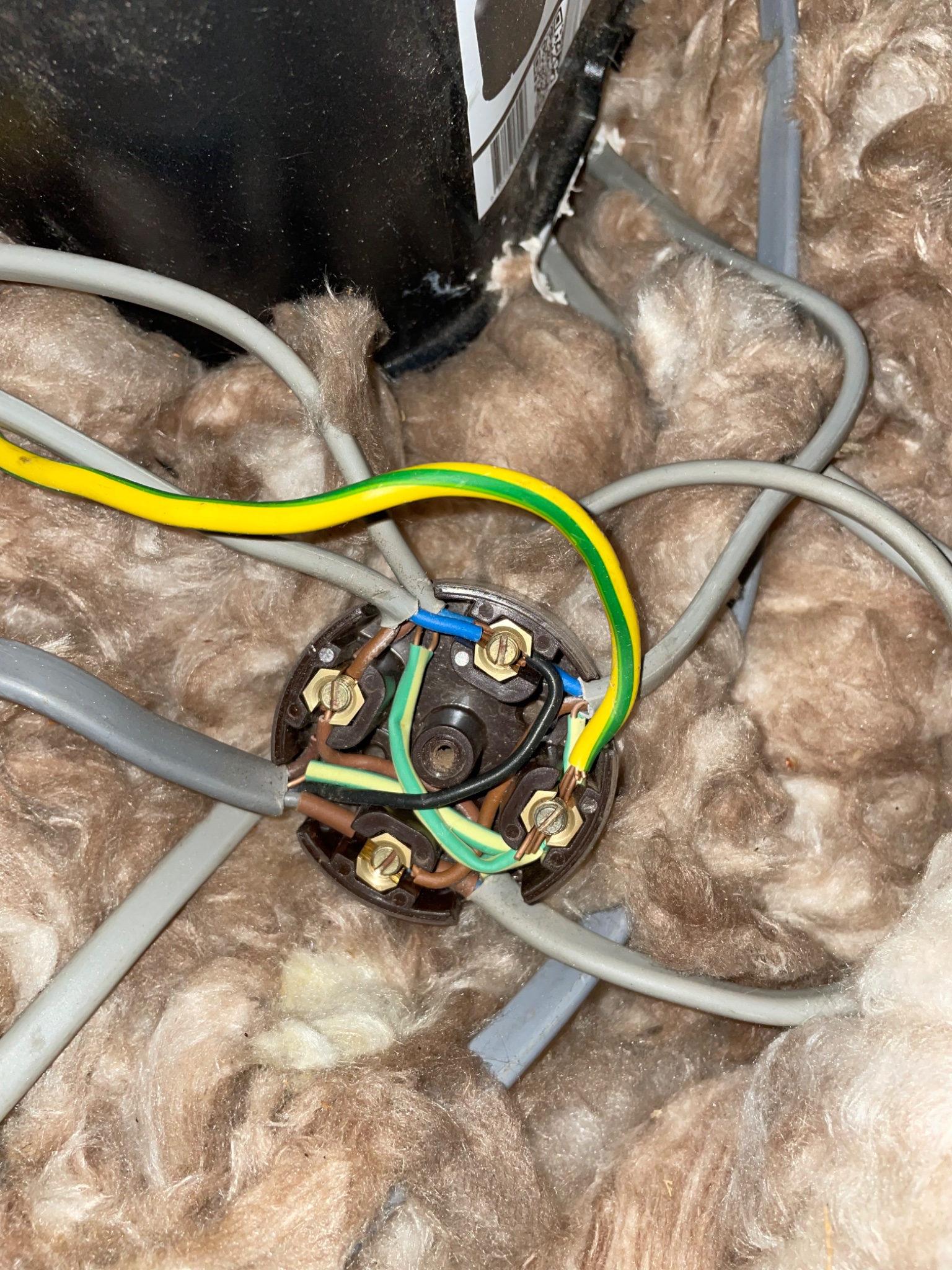

I recently moved into a house with 4 Ceiling LED lights in the bathroom. It’s clear the previous owner liked to dabble in electrical work. Two have stopped working after the worse were moved with insulation work, and the other two don’t switch off fully - they ghost. I’ve looked in the loft at the connection (photo attached). I’m going to go back to basics and check all connections to each light but would the dodgy earths have anything to do with ghosting
Also, any value in putting these in something more modern - Wago connectors within a box?
