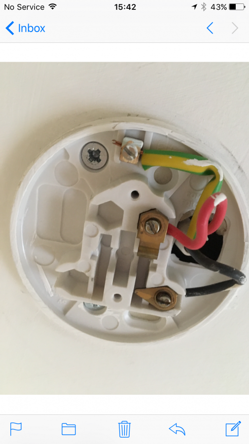

Do you recognise this light pull.
Trying to get the same one as I need to send it some distance away.

Only this M0916/8
The lady who is to fit it needs to change like for like as no drill etc to start drilling etc holes to mount to ceiling etc.
Hence trying to get the same for her.
The one in place has mounting holes at 5 to 7 or 5 past 7
The one I have are 6 o clock.
Most will have holes at what you call 6 oclock and 12 oclock, as thats standard to fit on a besa box, your one seems to use a hole at 7 oclock, that hole as you know may be exclusive to your make.
It looks like the front bit clips on after wiring the base, is it just not a case of reclipping yours back on

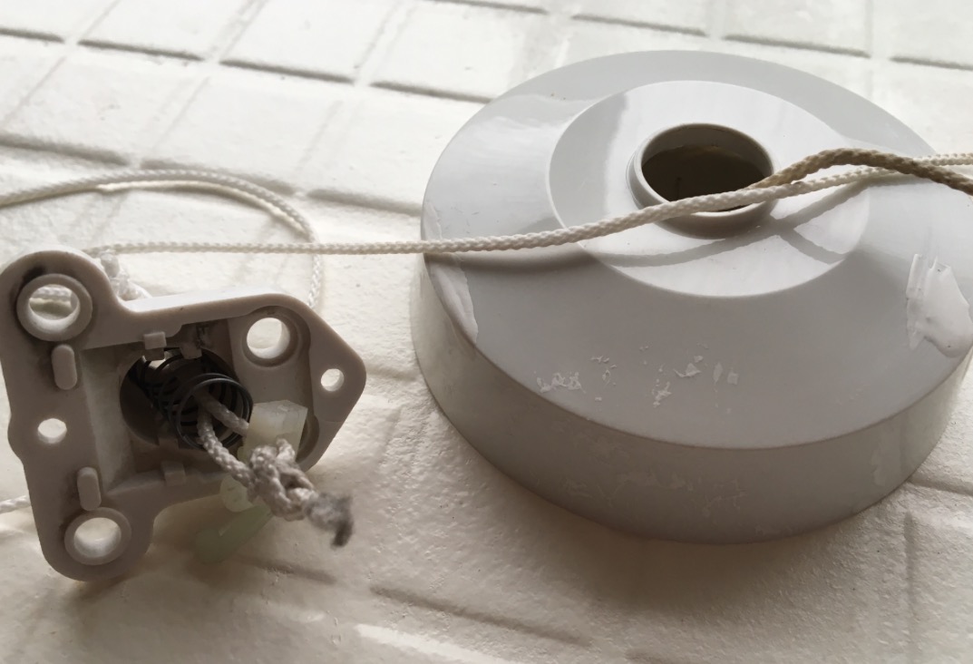

I see on Evay F1351 which is a 2 way.
Will the inside be the same as my photo.
The string was pulled and came straight out the ceiling part. Once the first part of the ceiling item was removed the part which the string connects to & rocks to make contact etc was it bits. Thus leaving light on etc, now sorted that part.
Hoping to buy the same part and just even leave the base as it is and use the screw on bit with rocker only.
You will have to reassemble it; they don't come off in one piece.
That would be the same as repairing the present one.
looking at it maybe it does, how else would you access the terminal screws.
Unless other parts, with access holes have been removed maybe
