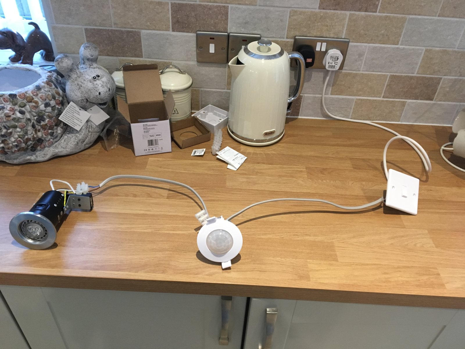

Hi everyone, any thoughts on the following - We have 10 LED downlights in our bathroom and have decided we would like 1 downlight to come on at night activated by a motion sensor, and place a light switch in a cupboard in a room behind the bathroom to be able to isolate it.
I would disconnect 1 downlight from the daisy chained downlights and placed in a junction box and as we’ve got an empty plug socket in the attic would it be safe to run a cable from the LED downlight we want to come on at night to a motion sensor to a light switch then to a plug socket? Ive included a pic which ive put together all the items and they all worked as they should. Just curious as if this would be a safe setup?
Thanks for the advice.

Plugging fixed lights into a socket is a bit tacky - can you not just hard-wire it into the lighting circuit? (Does it loop at the ceiling, or the switches?)
What's the idea behind having this? Have you tested just one light on to see if it would do what you want?
What's the purpose of the switch in the cupboard? Yes, I know, "isolation", but when and why?
PS - 10 lights in a bathroom?
Do you need 10 because the room is enormous, or to get round the problem that the lights aren't actually very good at the job of lighting the room up?

Ye it could be hard wired in to lighting circuit but not fully confident to do that. Ye we’ve tested 1 light on and its perfect for what we need, when my son goes in to the bathroom at night the clicking sound from the light switch along with half the lights coming on is waking our 2 year old daughter up.
Unfortunately the bathroom was always fitted with 10 when we moved in, we will be removing 2 downlights, 1 will become a ceilinv speaker and the other one will be replaced with a ceiling flush motion sensor.
The motion sensor ive bought will stay on for a selected time, however if it detects movement within the countdown time it restarts the countdown without the light switching off.
I presume it does NOT have a photo cell so will work during the day as well.
Not really a problem but if someone switched it off you may forget to switch it on again.
Yes, they do - but if standing still or sitting down, it will switch off and arm waving will become necessary.
You'd better warn your son - or he can play with it in the day time to get used to it.
