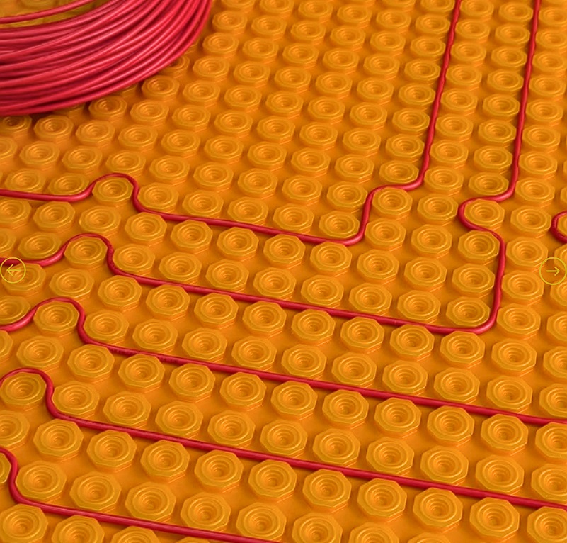

Thinking of using this kind of decoupling mat over the insulated floor.
Can I just put a marine plywood surface over this ready for the vinyl?

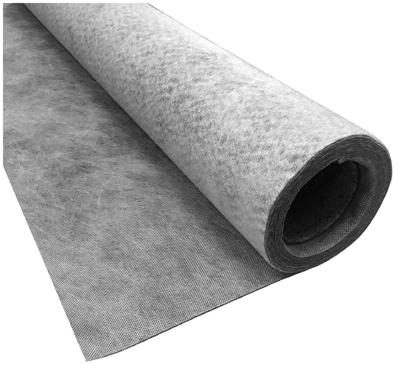

Or would I need somthing like this over the decoupling mat, then marine ply, then the vinyl?

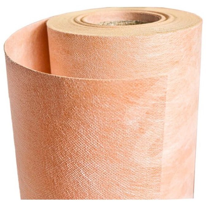

Option A - Soundproof & Waterproof Mat
Option B - Shower Liner

The UFH product will specify what the manufacturer recommends but in short the vinyl will need a stable firm surface, nothing spongy etc.
Thanks CD.
In your opinion, would marine ply over the orange decoupling mat be fine?
