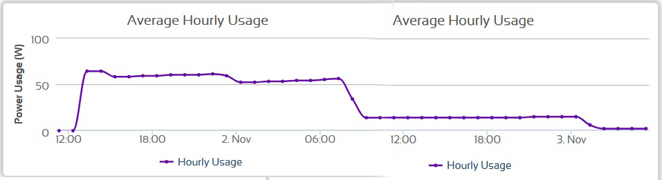

The 75 Ah was far faster it was a new battery 2 months ago, the chart is from energy meter so first peak 12.30 to 1:30 is the other charger getting the voltage high enough for the charger to start working, the dip 2 Nov is where it dropped from 3.8 amp to 3 amp, and between 6 and 12 it dropped to 0.8 amp and 3 Nov dropped to 0.1 amp, not really nice curves energy meter software has done that.
However it did take from Wednesday to Friday to recharge the battery, however it does actually tell me when fully charged it's not look at ammeter and guess.
