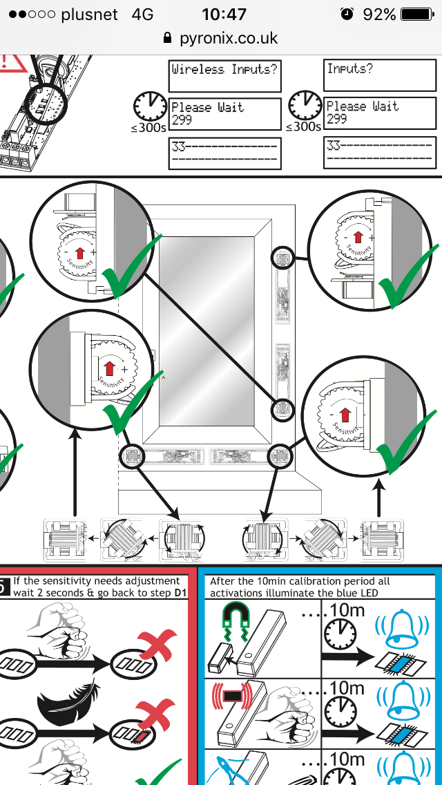

IMG_1674.PNG Did you happen to move the shock sensor internal sensor ? As it needs to be the correct way up ?
Arrow must be facing UP... forget the sensitivity + - marked on it as these things are rubbish and poorly designed. These devices are one of my most common callouts.

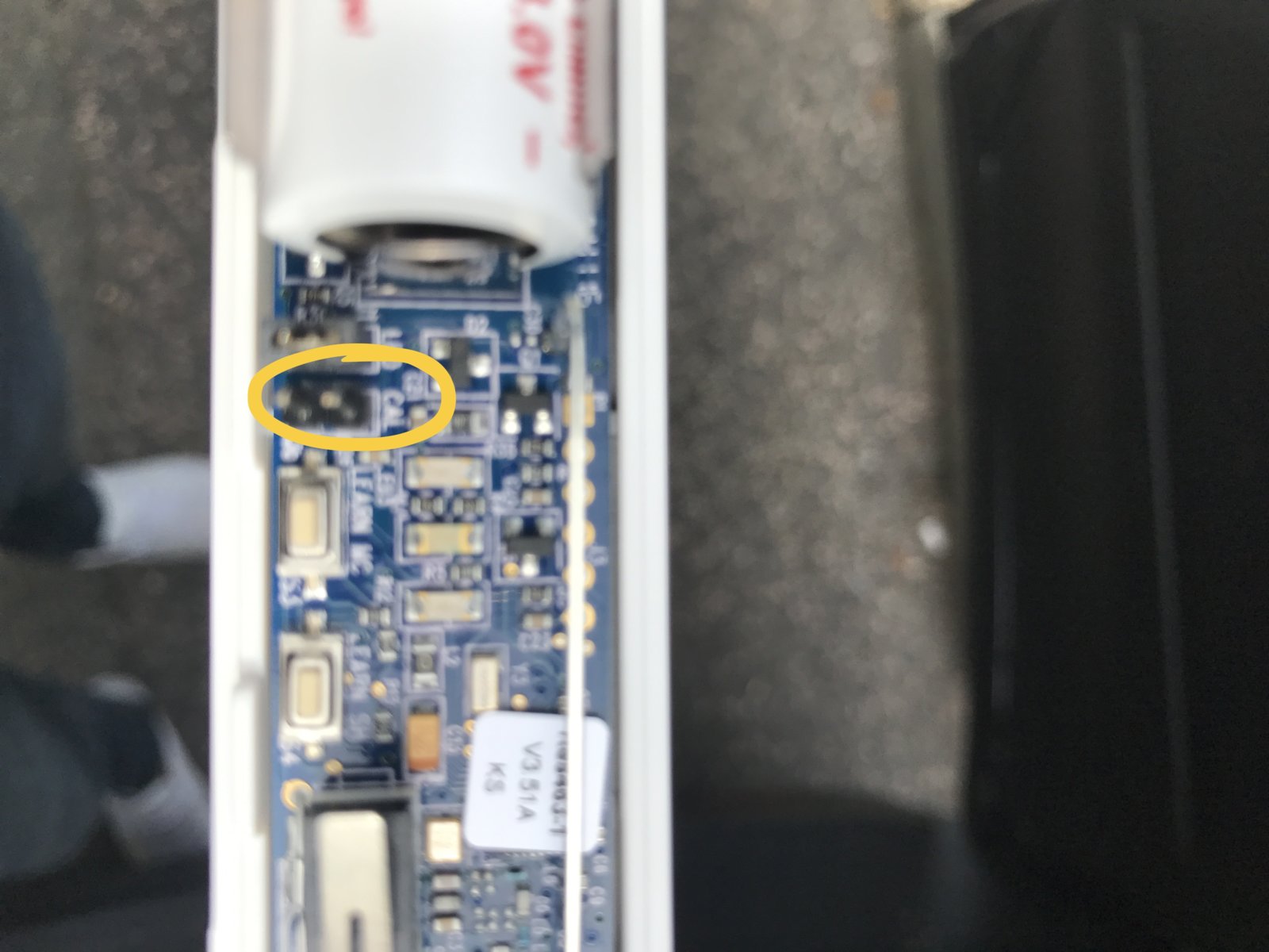

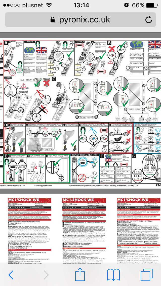

The things are a nightmare and always false alarm. The correct calibration procedure should be carried out by placing a short between the CAL pins then simulating the impact in whch you want it to trigger then release the short on the CAL pins. However this rarely seems to work, also earlier versions of these would forget the saved calibration when changing the battery! Newer updated ones have a software sticker on PCB of 3.5. Also a foam pad on the lid to hold the tumbler & white wires going from tumbler to PCB... if these are Black then its an earlier one & will need calibration on each battery change...

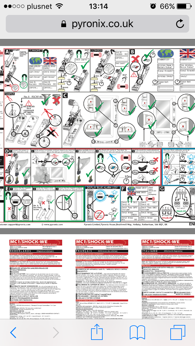

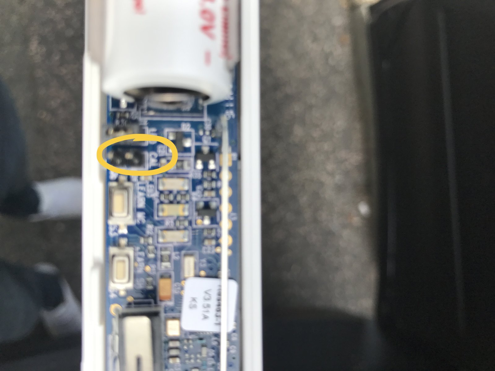

I got wireless MC1/SHOCK-WE. If I take the battery out and do the calibration do i need to re learn this to main board? Where do I need to put the jumper to calibrate I cannot find the those 2 pin as shows on the manual?
I hve this manual too but I can't find the 2 pins they pointing D section
