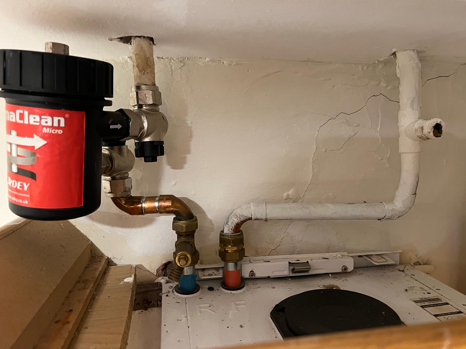

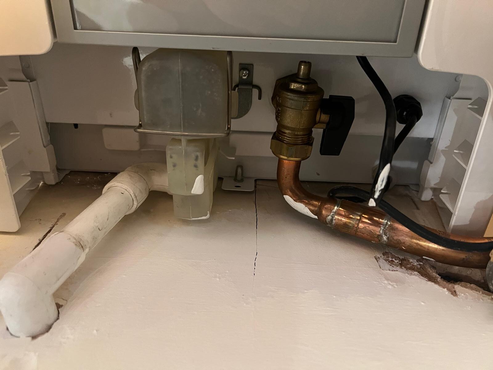

No bypass valve as far as I can see (photo of piping below).
When I turn the controller for heating on, the boiler turns on (audibly and the lights turn on appropriately), then after about 30seconds, you can hear the boiler turn off and the error lights flash as described.

If it’s overheating (which it sounds like it is) it can point to:
Circulating pump
Motorised valve (not opening at all or fully)
Lack of water in feed and expansion cistern if you have one

That doesn’t be show much unfortunately, just the gas pipe and the base of your boiler
Thanks, theres a pic above and below. One is gas pipe, other is water pipes.
I could only see one photo before. Just make sure those filter isolation valves are ope, if you look at the chrome plated flat bit, should say whether on or off.
